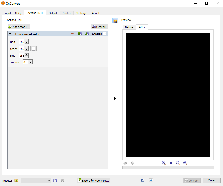

However, we need them with transparent background and Nconvert would be ideal to run from a command line to set the color white to transparent.
Its a piece of cake with XnConvert (see screenshot), but despite searching and trying, I wasn't able to get the same result as in XnConvert with NConvert: Simply replace with (255 255 255) with transparent color.
Does anybody know how to do this?

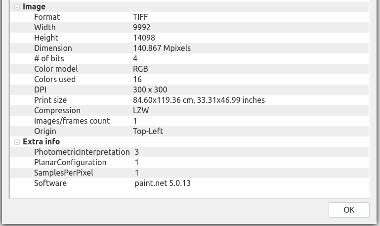

These are the properties of your attached test image:
Could you please post the properties of the original full-size image using XnView MP Image > Properties...
I am concerned that your smaller test image may have different properties.
You might be better making a crop of a small area of a full size image, and then ensuring that it is saved with identical properties to the original image.
You should also please ensure that your test image converts to transparent using XnConvert so that the test image is valid.

- Posts: 3042
Re: Transparency for
you messed your BW file while editing/saving, fixed one:
also check TIFF's compression settings to reduce file size
you cannot have transparency in 1bit monochrome image, so you need to convert it into:
- indexed (PNG) OR
- 32bit (TIFF, PNG)
- indexed (PNG) OR
- 32bit (TIFF, PNG)

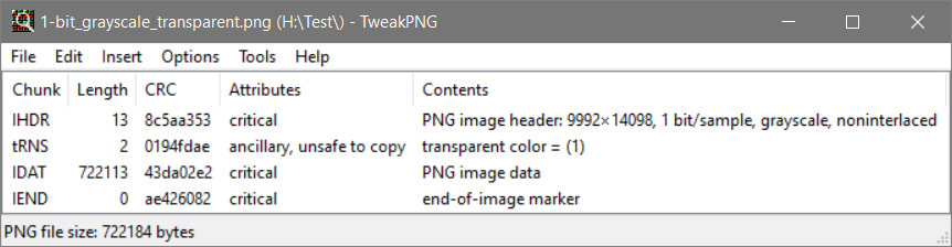

- Download and extract the sample provided by Micharius.
- Open test_white_1.tif in XnView Classic.
- Go to Image → Convert to Binary → Binary (No Dither).
- Go to Image → Convert to Colours… and select 8 colors without dithering.
- Go to Image → Edit Palette… and Enable transparency for white.
- Save the file as test_white_1.png.
Result: 4-bit indexed with a 16-color palette and alpha channel transparency (1'006'671 bytes) - Optimize test_white_1.png with PngOptimizer (lossless).
Result: 1-bit grayscale with transparency (722'184 bytes)

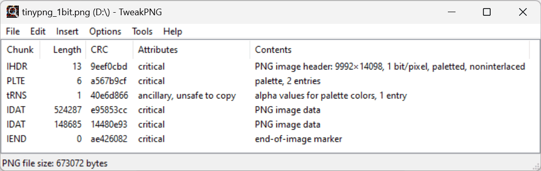

- Posts: 3042
hm.. tinypng.com reduces 4bit with transparent index from 1Mb to 673kb
which can be resaved in xnviewmp as 32bit avif (523kb, 15mins) or webp (776kb, 2mins)
