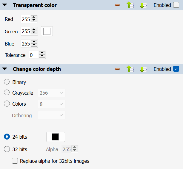

if you convert:
- 32bit image - run as is
- indexed - also enable "Transparent color" action (any color/any tolerance, no idea why :D )

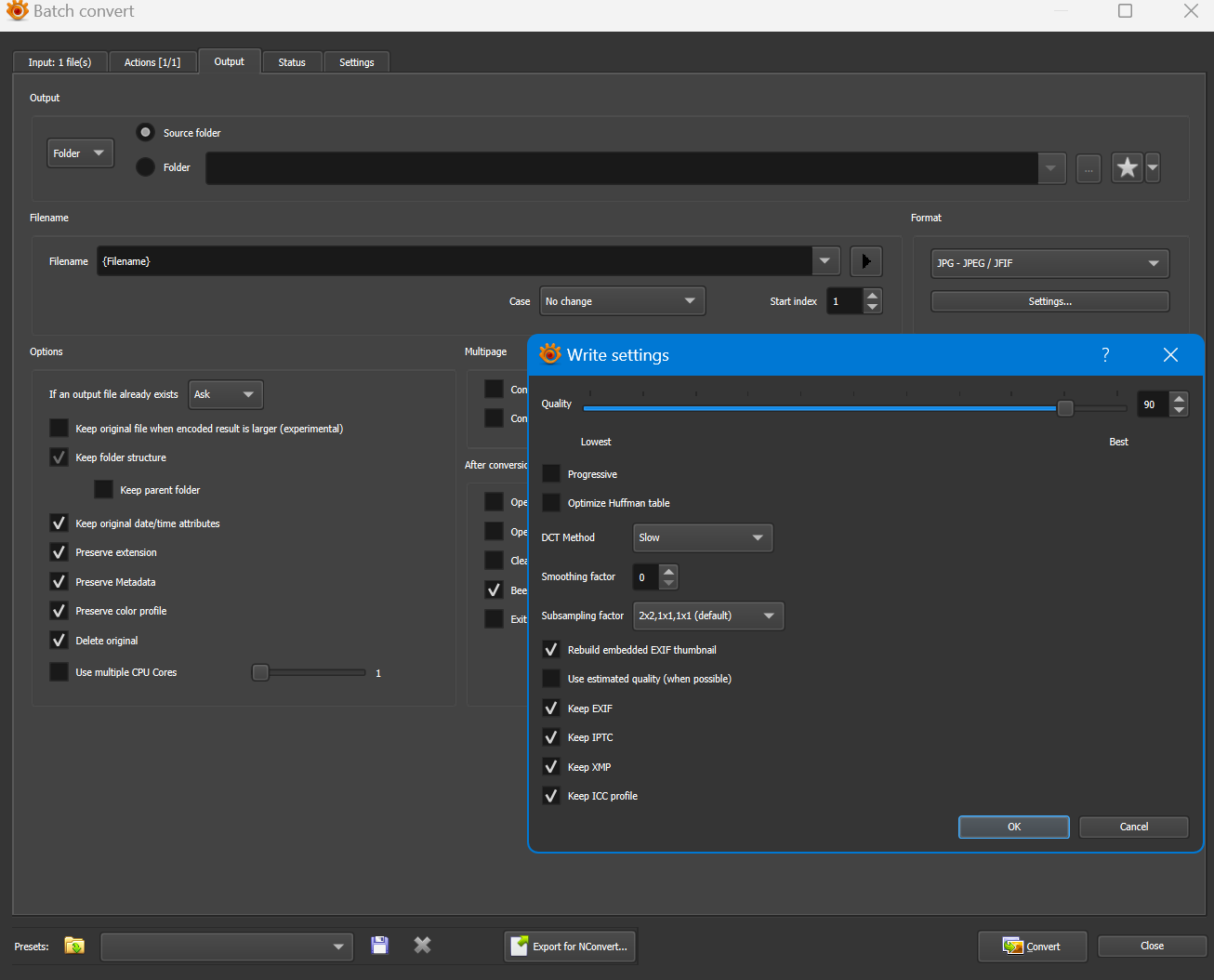

xinni wrote: Mon Sep 23, 2024 9:08 am I'm trying to batch convert some pngs with transparent background to JPEG format with black background color...
... then set Output tab format to JPEG with your desired saving settings.

cday wrote: Mon Sep 23, 2024 12:14 pm
Out of curiosity and because your solution reads so easy, where would I do that?

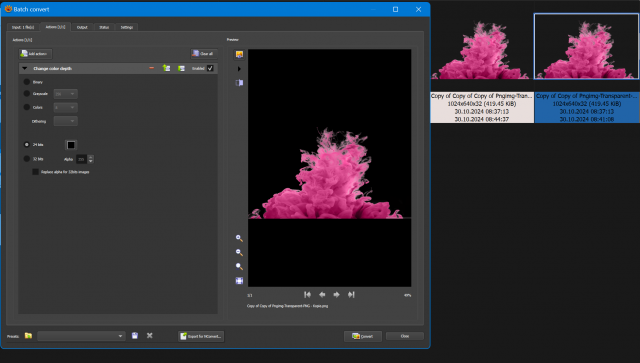

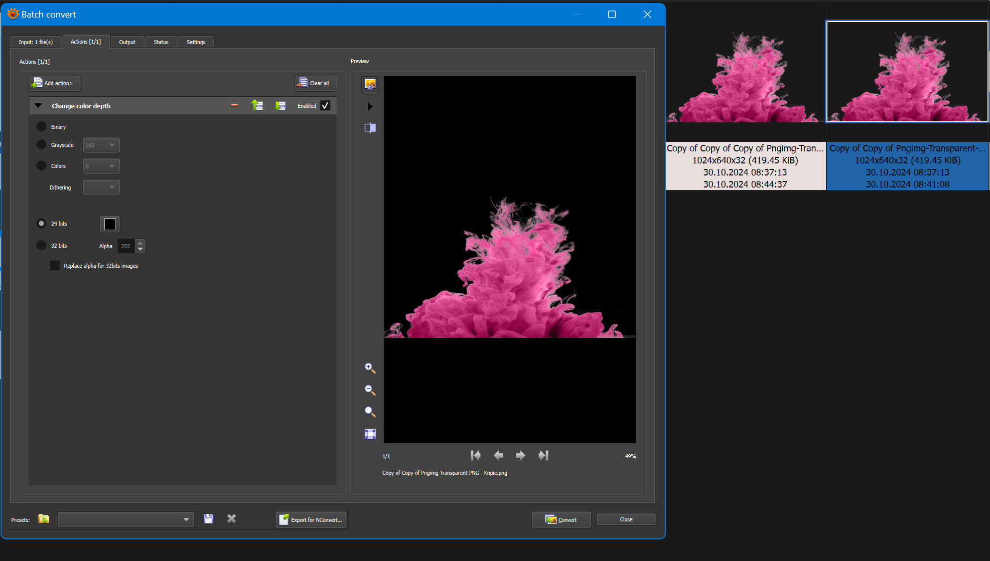

Thank you,
"run as is" did not work, or I can't figure out what you mean by that.
The only way, I could get it to work (for 32Bit images) is this:
That seems odd to me, when I read both of your "easy" ways to do it.
