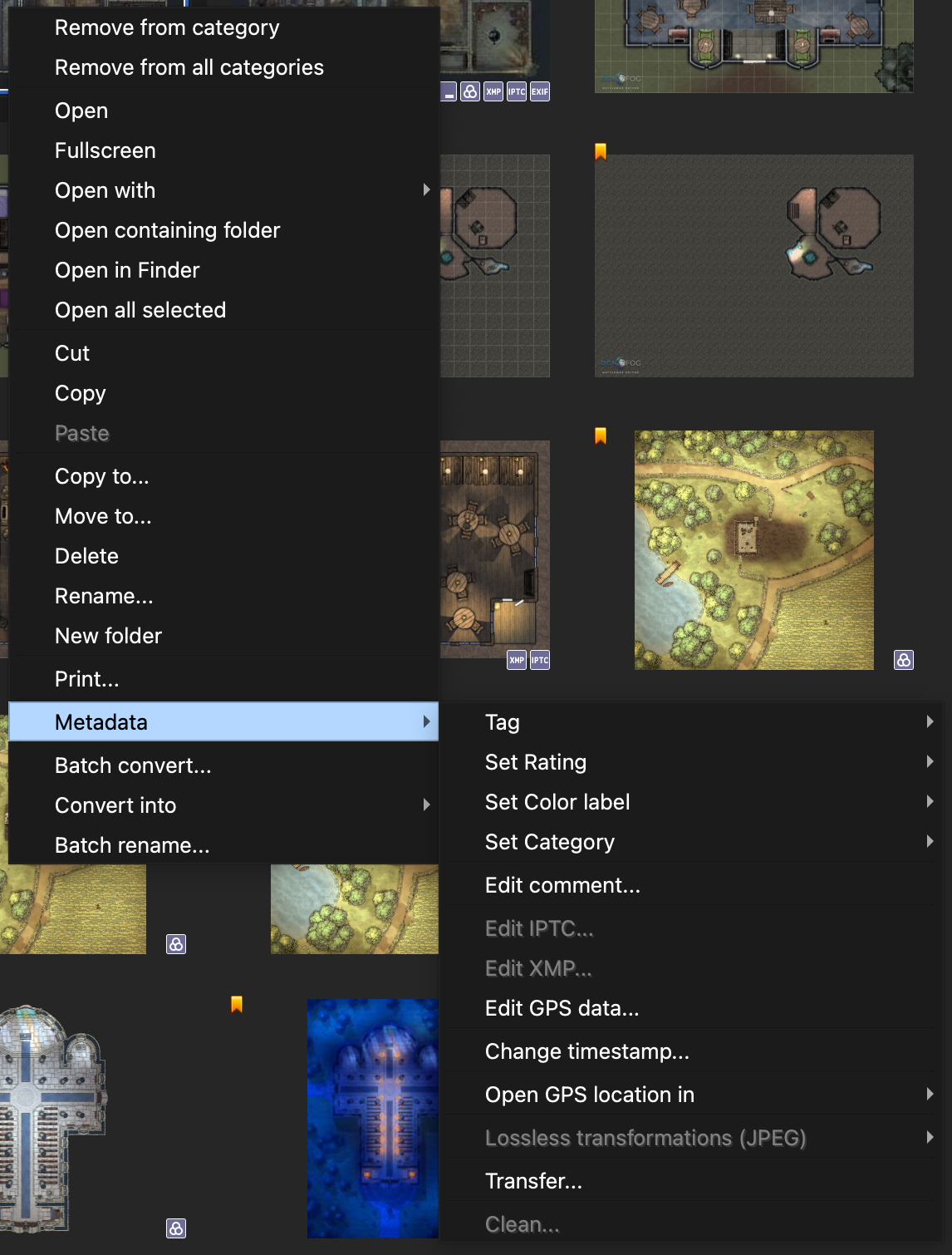

Is there any way to embed categories set on an image as a keyword directly into the XMP info in the image?
I've got my images sorted in categories in XnView. but now need to export a bunch of them to another platform. And it seems that using keywords in XMP works the best. So now I'd like to mass embed the categories for the images I need to export.
I can do it manually by assigning keywords by hand, but I haven't been able to find any export setting or conversion setting where I can do it as a batch based on the already assigned categories. :D
And bonus question: Why are there files where I can't edit neither IPCT or XMP data? :?

First, add export options in Settings >Metadata.
XMP metadata are now the most recent , used by many softwares.
Disable "Create Sidecar" in sidecar tab if it was set
Some formats support embedded metadata, some formats don't... (For example, for now XnViewMp is not able to create embedded XMP in webp)
Two methods
- Select a set of photos and use View>Update files from catalog
- Select a category in the catalog filter panel, select all the photos (ctrl a) , uncheck / check (slowly) this category in the "Categories" panel., release selection to make keywords be written...
For 1st method, you can use View>View files in subfolders.
