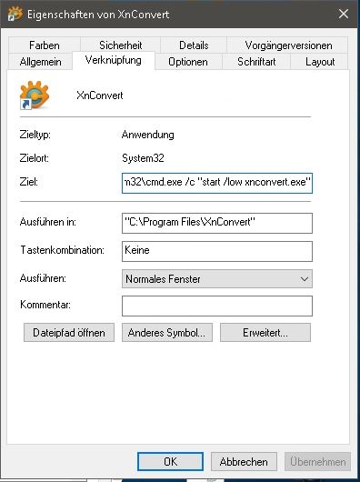

Edit:
As a workarround I created a shortcut (right mouse on desktop, create shortcut) calling cmd.exe that runs startcommand with /low parameter. Its not idle but probably good enough.
Screenshot is german, but i am sure anyone who wants to set cpu priority will understand.
Ow and I also changed icon from the shortcut to look like the one from xnconvert.
If you have same directorystructure like me, you can copy n paste command for shortcut (I am on 64 Bit System and it works):

Edit:
C:\Windows\System32\cmd.exe /c "start /low xnconvert.exe"
