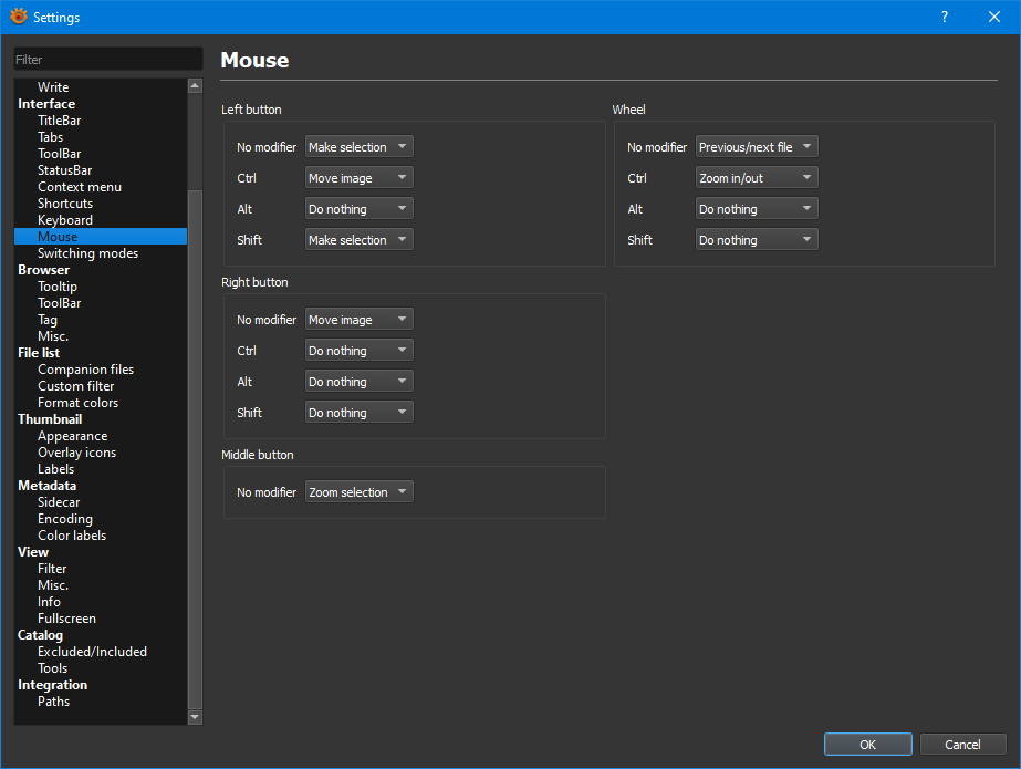

what do you have in Settings>Mouse?

I have the attached.
I imagine the problem here is that XNView needs to look more widely than shift, ctrl, alt in order to consider the wheel has no modifier (not just for this issue, but there maybe other similar ones where "no modifier" is calculated). Ideally no other key of any kind anywhere on the keyboard should be being pressed, but if that's not trivial then it may be different keyboard layouts could be considered as to what's around the shift, ctrl, alt that could be accidentally hit instead of those modifiers. In this case it is the context menu key immediately right of the ctrl key. It's an issue here because it scoots through the files. I suppose a workaround would be to make the move-file itself a modified mousewheel but I think the general issue of how not-modified is calculated needs addressing.
