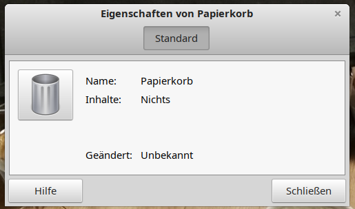

These are my Trash Properties:

Re: Recycle bin not working
Thanks, I just logged on to edit my last post to include that I am using Linux Mint Cinnamon 20...
Note that it is probably necessary to enable display of hidden files to view the menu I posted.
In some ways this does seem like a possible rights problem, but too technical for me, I just use Linux to avoid using Windows!
