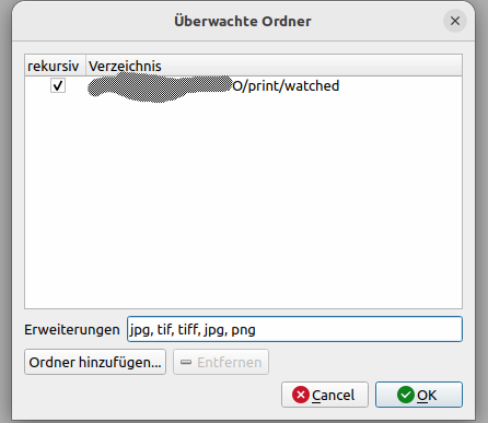

I am not sure how to start or activate it.
I have checked the checkbox and added a watched folder - but nothing happens if I copy a new file to this folder
What am I doing wrong?
You have entered one or more appropriate file extensions in the Extensions field?

thank you - yes I added extensions too - but nothing happens,
input: .../print/watched
output: ../print/out

Batch convert dialog is opened? you add files in .../print/watched and convert doesnt start?

i've just tried on linux and it works. 'Hot folders' button is checked?

just installed the newest version and tried it again - did not work (for jpg)I tried to not use jpg but png and now it worked.
I then remove all extension in the list and only had jpg and then it also worked on jpg.
I think the problem comes with the komas. Last test list is: jpg png - worked too!
