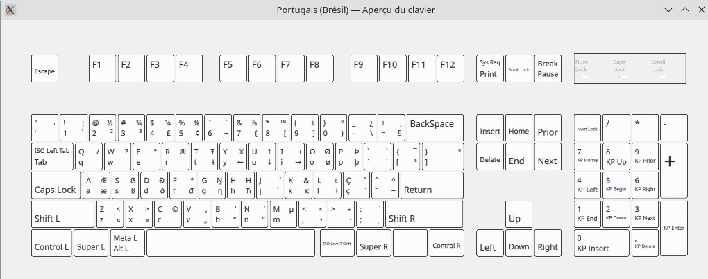

Post by Heitor »
xnview wrote: Thu Jan 23, 2025 12:26 pm How do you type accent with BR keyboard? Capture-1.jpg
I press the accent and then press the letter key. Pressing any key on the keyboard works, pressing an accent is like the key being locked.
When pressing any accent in any text box they are completely ignored, that is, they appear to be blocked. The 4 accents below are blocked from typing
