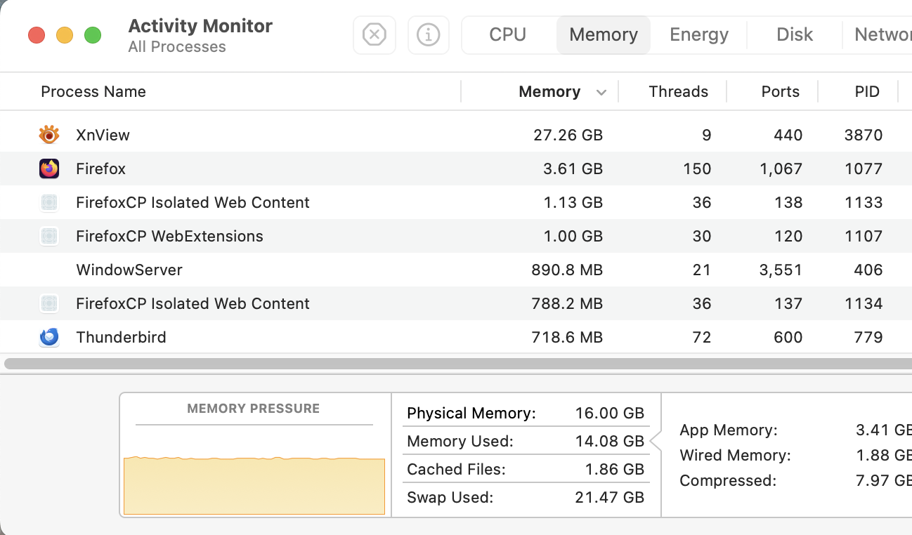

Attaching an example:
I just scanned a mixed media folder with subfolders containing ~48k items.
It didn't crash, but the memory usage went up to 23G, the screenshot I'm attaching is 5 minutes after completion of the scan and you can see that the memory still isn't released. I can click on another folder and most of that will be released, but I need to close the program and relaunch it in order to get a full release.
Update:
I realized that it's not the building of the thumbnails that's causing the memory blowout, it's just loading them. The previous 48k folder was itself a subfolder. After I built that and several others I built it from the parent (~89k mixed-media files). The memory use went significantly higher, (27G) and didn't release. I closed and reopened the program, went to that folder and selected "Show files in subfolders" at which point, the already built thumbnails were loaded into memory. Screenshots attached:
