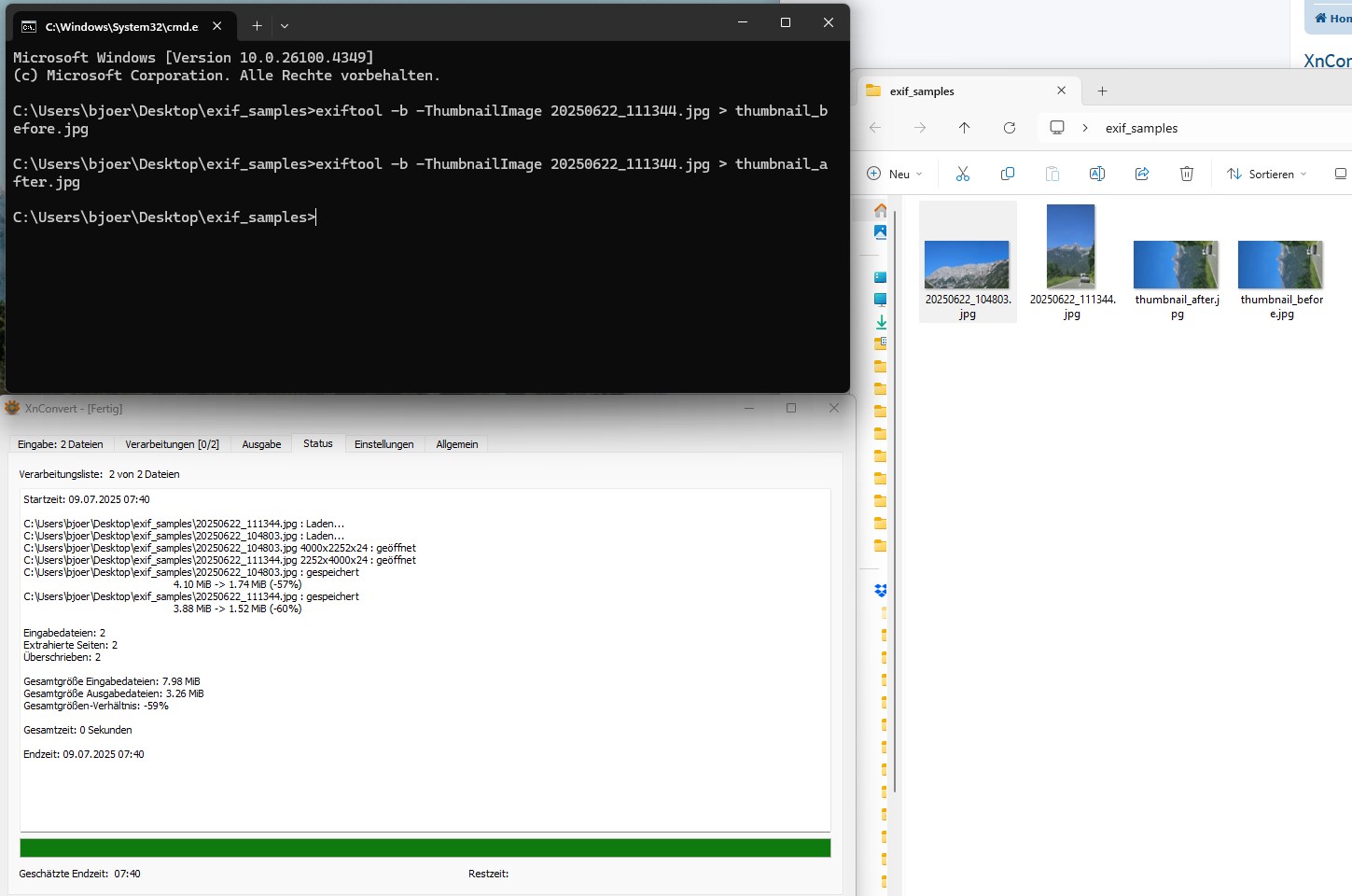

Thank you for your help - I ran some tests and I can't seem to properly understand the combination of different checkboxes - it seems buggy to me overall.
I have two input images from my Samsung S23, one in landscape, one in portrait mode. See here (rotation icon):
It seems to NOT matter whether I add the Action "Transform > rotate -> EXIF orientation" or uncheck it:
In both cases, the image itself is actually rotated and the EXIF orientation shows "Top Left" afterwards. So this part looks good and fine (even though I could imagine some ppl don't want the EXIF tag to be "reset" - but at least for me: This is exactly what I wanted).
The "buggy part" is the Thumbnail: Under JPG format settings, I activated to re-calculate the EXIF thumbnail, but the image thumbnail shows wrongly orientated both in XnConvert and XnViewMP after my compression.
It seems the EXIF thumbnails are not re-calculated properly...
It looks like this (you can clearly see, the orientation was reset to "Top left" but the Thumbnail is wrong:
I also verified it when I ran this command before/after: The extracted thumbnails are binary-identical before/after
... run xnconvert here ...

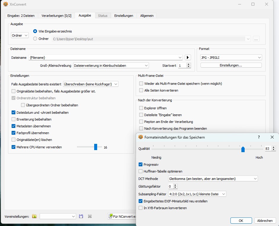

Re: [Bug in XnConvert] XnConvert - Rotate based on EXIF orientation
Post by sx090 »
Did you use "JPG - JPGli"?
I tried it again, with my actions deactivated, and the following settings (for JPGLi):
Here's the Log and the demo of before/after Thumbnails:
Yes, using "XnConvert Version 1.105.0 - windows x64 (Apr 16 2025) - Libformat version 7.221".
I then tried the regular "JPG" format as target format, and it worked properly....
Could this be due to JPEGLI format?!
Thanks!
