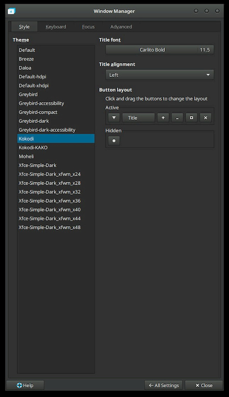

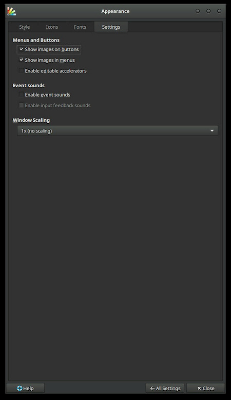

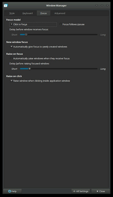

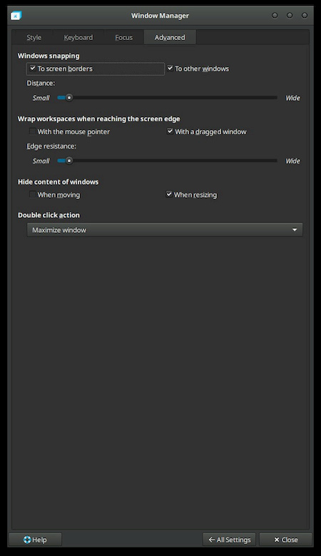

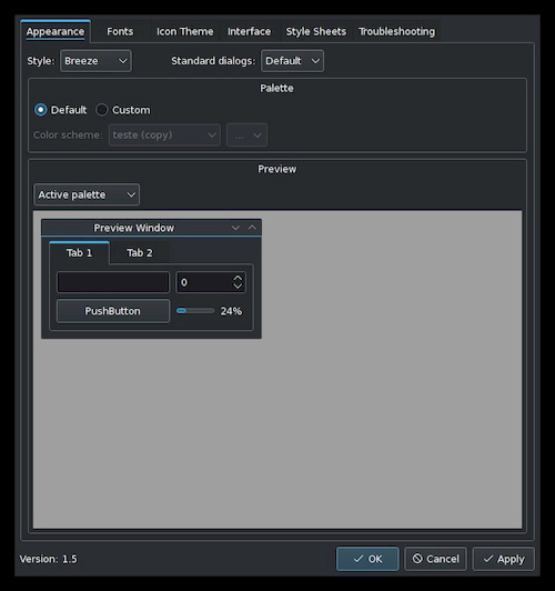

Posts: 46959
Re: 1.9.x: Significant bad performance on some Linux Xfce/GTK Desktops
xnviocumo wrote: Sat Aug 30, 2025 8:34 pm I am sorry that you were not able to reproduce the issue. Perhaps my own instructions to reproduce it are not detailed enough. So, for exampled, perhaps I should include other conditions, such as the need of configure the "Style" and the "Icons" in the Appearance section of the xfce Settings with the same values I have: In Style, I use Xfce-Simple-Dark, and in Icons, I use a Qt theme, Korla "dark icon theme for Linux desktops".
could you send screenshots of 'appearance' & 'window manager' settings? and perhaps 'qt5 configuration'?

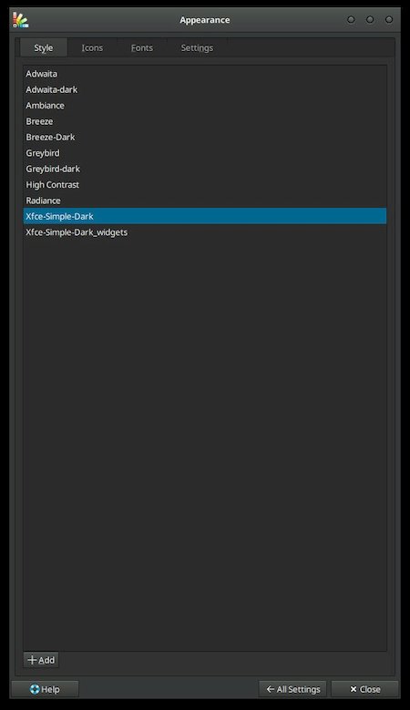

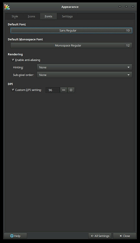

xnviocumo
Posts: 29
Joined: Mon Oct 17, 2016 12:11 pm
Post by xnviocumo »

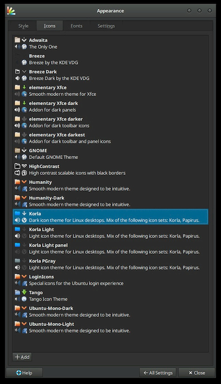

Appearance
Window Manager

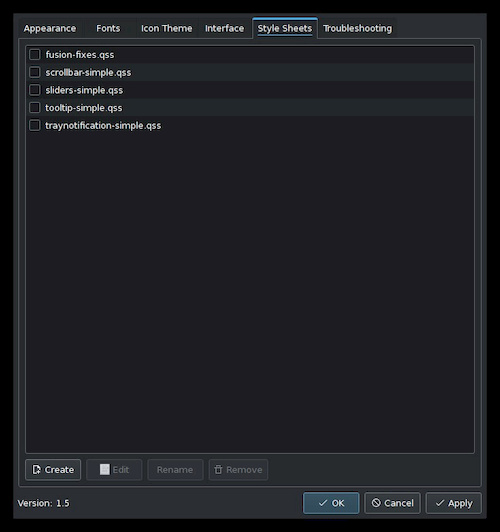

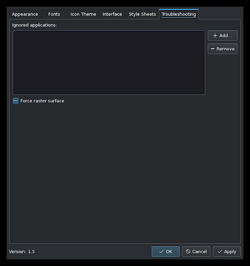

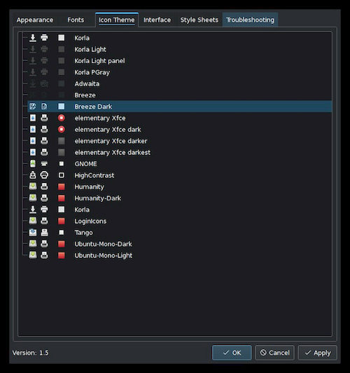

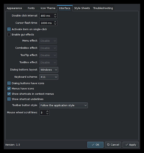

xnviocumo
Posts: 29
Post by xnviocumo »

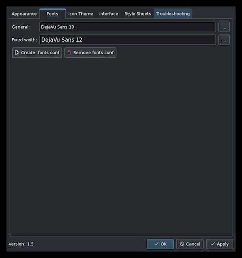

Qt5 Configuration Tool

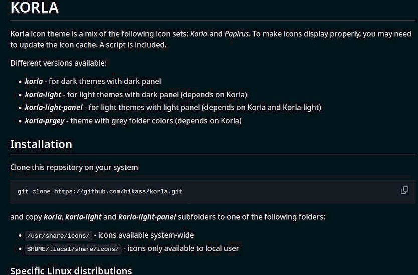

Posts: 46959
thanks, do you remember where to download it? I fund only Kora theme and not Korla
And in Qt5 configuration, i have only Fusion&Windows
xnviocumo
Posts: 29
Post by xnviocumo »
Oh, yes of course. Sorry I should have mentioned already:
Here it is the Github repo:
https://github.com/ctlos/korla
I actually still have the zip I downloaded 5 years ago, which I don't attach here, just because it's 12MB, thus not possible in this forum, but if for any reason you are interested, I'll find another way to send it.
Now: korla is indeed a fork of the kora project, as stated in the korla github page. I don't know what the differences are, both projects are 6+ years old and seemingly very similar, obviously. By the time I picked this one, I don't even remember if I knew about 'Kora', I just found this one with a fantastic huge amount of beautiful icons, specially dark, and I think I most likely found it in the xfce-look.org site, but now apparently it doesn't mention korla, but kora. Perhaps kora is being more active now.
Posts: 46959
Perhaps you can send me a link to download on PM, and please tell me how to install it?
xnviocumo wrote: Tue Sep 02, 2025 5:24 pm Oh, yes of course. Sorry I should have mentioned already:
