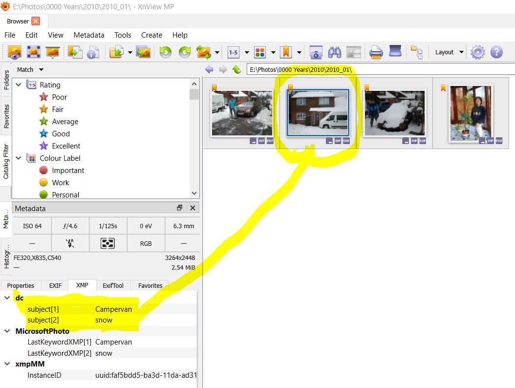

I am still not finding any images when searching for categories.
My observations.
I tag my images using Windows Explorer or CyberLink Photo Director and the tags are visible in these programs – if I tag it in one I can see the tag in the other.
XnView does not use the term tag in the same way, it uses categories. The tags 'campervan' and' snow' are shown in XnView under Metadata/XMP/dc/subject, see attached screenshot.
However my tags, e.g. campervan, are listed in the categories along with categories preloaded in XnView, e.g. Audios, see screenshot.
Hopefully this helps to solve this issue. Thanks
My observations.

Yes, xmp-dc:subject and iptc:keywords are "Keywords" and will be mirrored in the "Catalog" as "Categories"XnView does not use the term tag in the same way, it uses categories. The tags 'campervan' and' snow' are shown in XnView under Metadata/XMP/dc/subject, see attached screenshot.
The word "tag" is ambiguous anywhere
