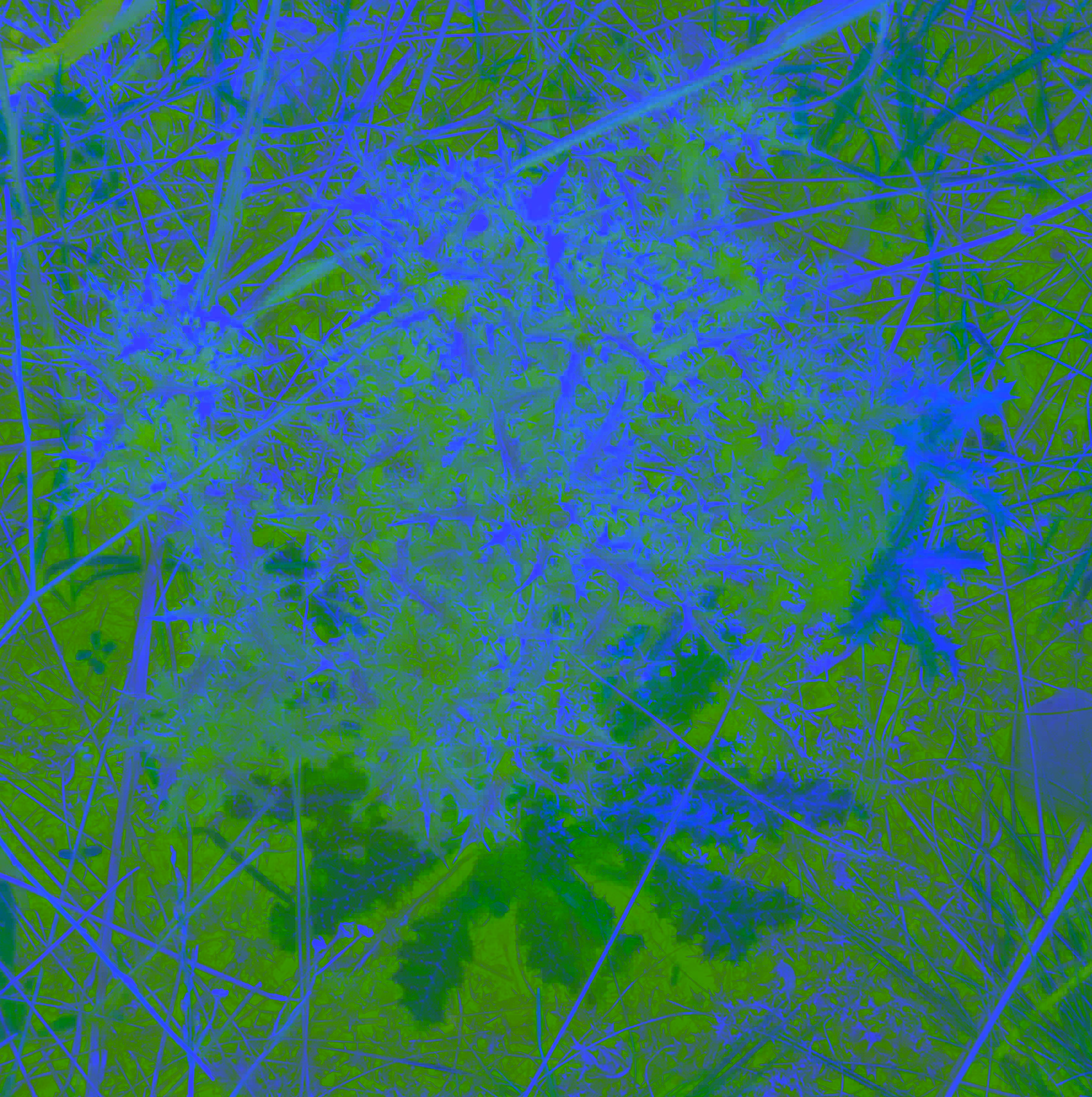

The attached was saved XYB Jpegli 4-4-4 progressive (XNView 1.9.5)
When a lossless crop is applied the colours are messed up. In non-XYB form this doesn't happen. Lossless rotations are fine.
So I think either the issue needs fixing or the lossless cropping of affected formats needs to be blocked (at least until fixed).

Since (it seems) the resolution of the other slow cropping speed matter, cropping an XYB image now destroys the colour again - 1.9.9

If you have a jpegli XYB, when you do a lossless crop it loses the colour palette and the colour comes out wrongly.
This seems to be a reversion, in my comment above for 1.9.6 I had indicated it had become fixed.

This problem is supposed to be fixed in XnView MP 1.10.1. Please check and confirm the bug fix here.

For this one, using the ZIP, it does now retain the colour but it seems to run considerably slower than non-XYB lossless crop. I would have expected them to be comparable in timing?
This can be tested by taking a picture and saving JPEGLI with and without XYB and running a crop on each, their cropping time is notably different.

For XYB file i use Exiftool, i have a problem with my own code...meteorquake wrote: Tue Feb 24, 2026 10:46 am For this one, using the ZIP, it does now retain the colour but it seems to run considerably slower than non-XYB lossless crop. I would have expected them to be comparable in timing?

There is an issue remaining, which is a broken thumbnail.
In cropping a file
https://www.dcode.fr/exif-thumbnail -- shows no thumbnail
https://jimpl.com/results/eBNaKyZdNhWwe ... arget=exif -- indicates thumbnail data is present
Explorer/Everything - shows a broken thumbnail, with top half showing, lower half grey
I attach sample croppings showing this, the pictures themself are fine, just the thumbnails
