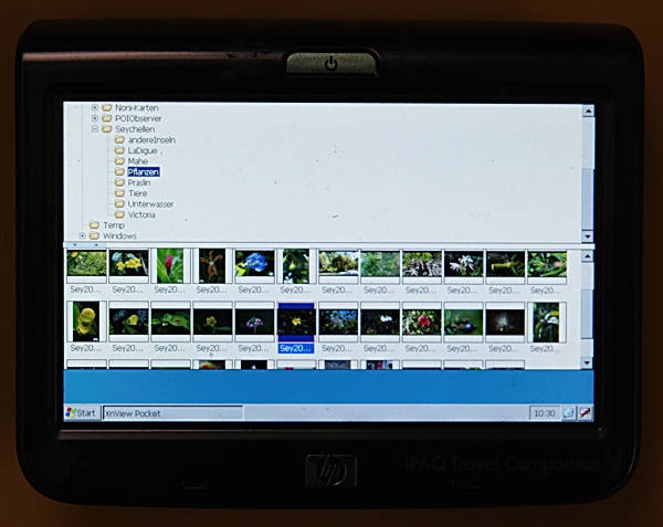

I knew the topic http://newsgroup.xnview.com/viewtopic.php?f=13&t=17892, but I don't have problems to install, so I started a new thread.
At first some informations:
- Normally the HP-own OS starts while booting up the iPAQ 314, so if you want access the WinCE 5.0 undelaying, you have to insert a SD-card (not SDHC!) with a programm called CELauncher.exe For this case I renamed a copy of TotalCommanderCE.
- It is imortant to install XnView in the 'ResidentFlash' ! Not in 'Program Files', because that is a temporary folder created by teh system every time when booting up.
So after starting XnView Pocket, it looks like the first attached picture: XnView doesn't use the whole desktop and there is no menu bar and a exit-button.

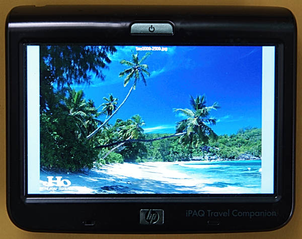

The second picture shows one of the files afte double tipping on a thumbnail - there are no buttons to go to the next picture or to return to the overview - I found out that I can click on the left lower conrer of the display for this.
Does XnView not properly work with the high resolution of the iPQA 314?

Picture 2: Displaying an image
Picture 1: XnViewPocekt on an iPAQ 314
