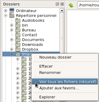

Roumano
- Posts: 115
- Joined: Sun Oct 10, 2010 6:20 pm
Re: Import XMP data
Just do that :
(before don't forget to select import from xmp in the option/metadata
Just do that :
