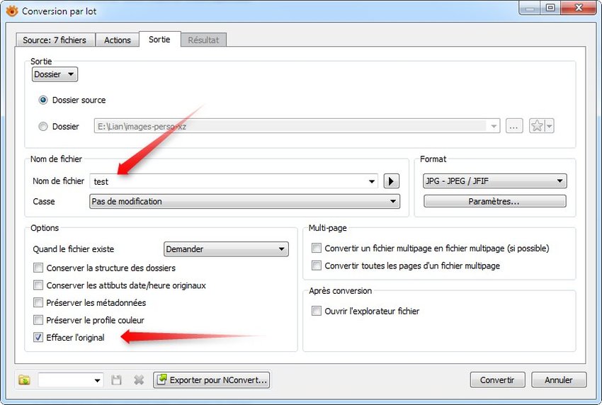

when making a batch rename, MP proposes to add by default an number to the alphabetical name if there is no indication of adding any number. But in Batch Conversion, the rename function does not act in similar way: if you don't ask to numerate the files and choose to delete "old files", well, you got only one file with the alphabetical name you put in. So all the others are deleted :mrgreen:

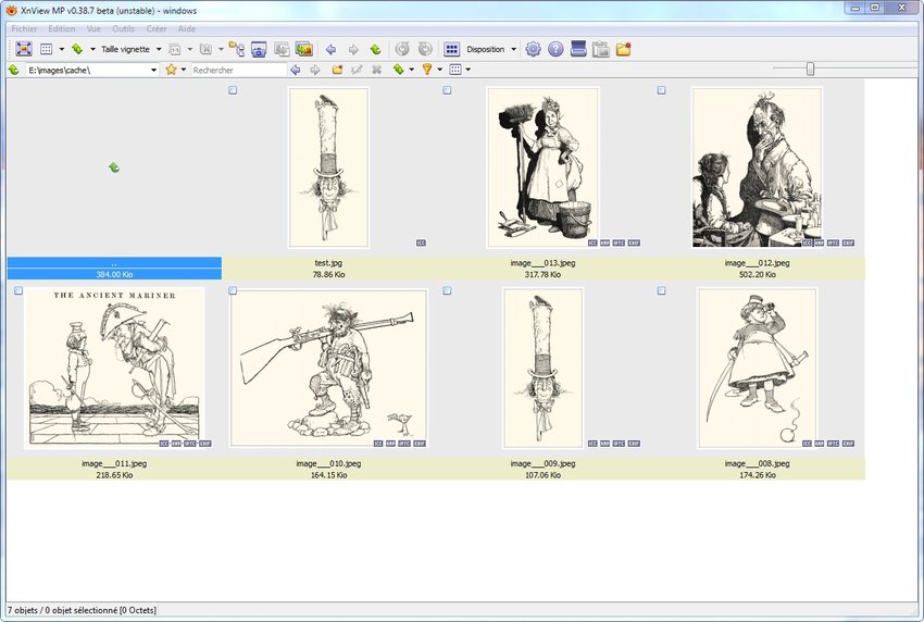

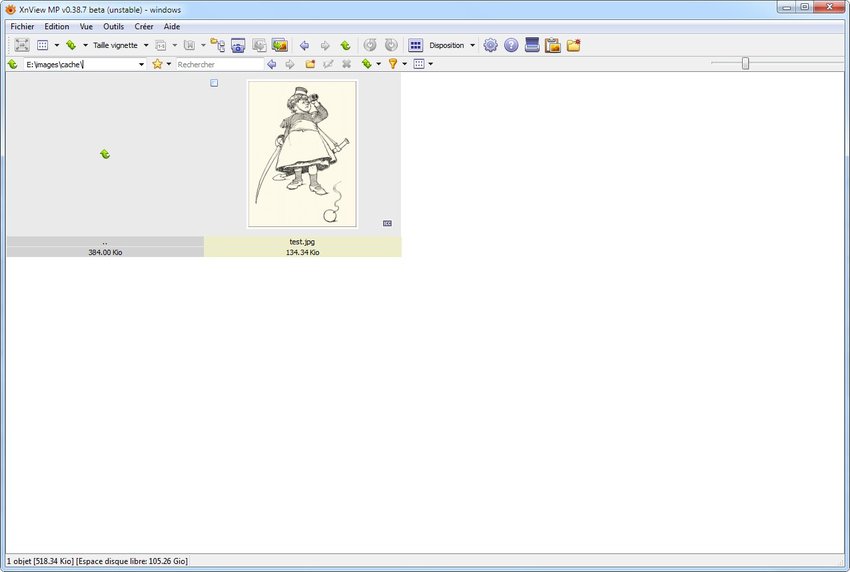

Wich version are you using ? With 3.8.7 I've got only one file left.

Posts: 48060
Re: batch rename and batch conversion
Could you post a screenshot, please?

It's your method that leads to this result!
If each image to ask you to overwrite (YES) and you have checked "Delete original", this will be your final image will have the name of departure, others have simply been crushed, one after the other! You also have proof in your test, it's your last image is named as you want
If you apply to each image "RENAME", all images will be renamed incrementally (1.2, .. 10) with the name of your choice! This is what you want is not it!
PS: The difference between your test and mine is in> When the file already exists: I have personally used "Rename" and you "Ask"
If you check "Delete the original, with" Rename ", the equivalent files in the name will not be deleted, they automatically include the list incrementally!
If you do not check "Delete the original, leaving" Rename the file name to be simply equivalent 2X doubled and included in the list incrementally with different numbers!

I understand what you say but I think the behaviour is not logical: as a batch rename does not consider renaming with only one name but need to add a number, I think the same logic should be used when renaming a serie of files in batch conversion mode. The behaviour follows the logic of MP but not the human logic (well, it's my opinion, I don't pretend to represent all people).

lian wrote:Éh bien, comme pour un batch rename: à savoir MP rajoute un numéro automatiquement derrière chaque occurence du nom pour conserver le même nom de fichier.
Ce n'est pas si simple, il faudrait lire toutes les images et suivant les options multipage, faire la modif...
En fait, c'est lié à la modif que vous m'avez demandé :) Si 'effacer l'original' est coché, ne pas demander...
