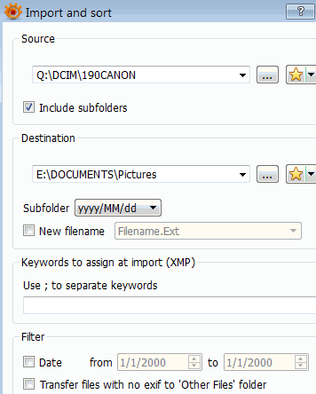

That said, I decided to plug my camera's SD memory card directly into my computer's slot for it. Then, XV (& even IrfanView) can read it (as SD/MMC).
When I plug in the memory card, what shows in regular Explorer, as a removable drive (assigned a letter), is "Canon DC."
At the same time, I can't find any Canon programs running. Don't know if it showing this AND XV being able to read the card is related to some Canon software installed (but doesn't work for the camera itself).
Unless (a stretch) this HP computer recognizes the memory card as formatted w/ a Canon camera, thus assigning "Canon" to the device, shown in Explorer. Dunno.
Since discovering this, I haven't fooled w/ it enough to learn what can be done (say, using XV to import pics) vs. just using Photo Gallery & the camera (connected w/ USB).
Then once pics are on the HDD, viewing w/ XV or others.
* Oddly, by this method, XV DOES allow importing from the card, from XV's File > Acquire. The "acquire from scanner / camera (WIA)" still doesn't work.

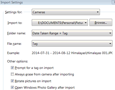

The initial, main goal of all this (there was a goal?) was not just a way to import pics from the camera, but an import method (software - GUI) that offers more options than native Windows import. e.g., tagging, renaming, sorting & options I've never heard of but probably need.
I can "just import" pics - from the camera - from Explorer, by R clicking the camera name that appears, then "Import." That offers *some* options to change data, before they're imported (see screen shot of XV & Vista import UI).
The XV import screen is from plugging the SD card into the PC. Maybe there are other options available during XV IMPORTING that I'm not seeing?
