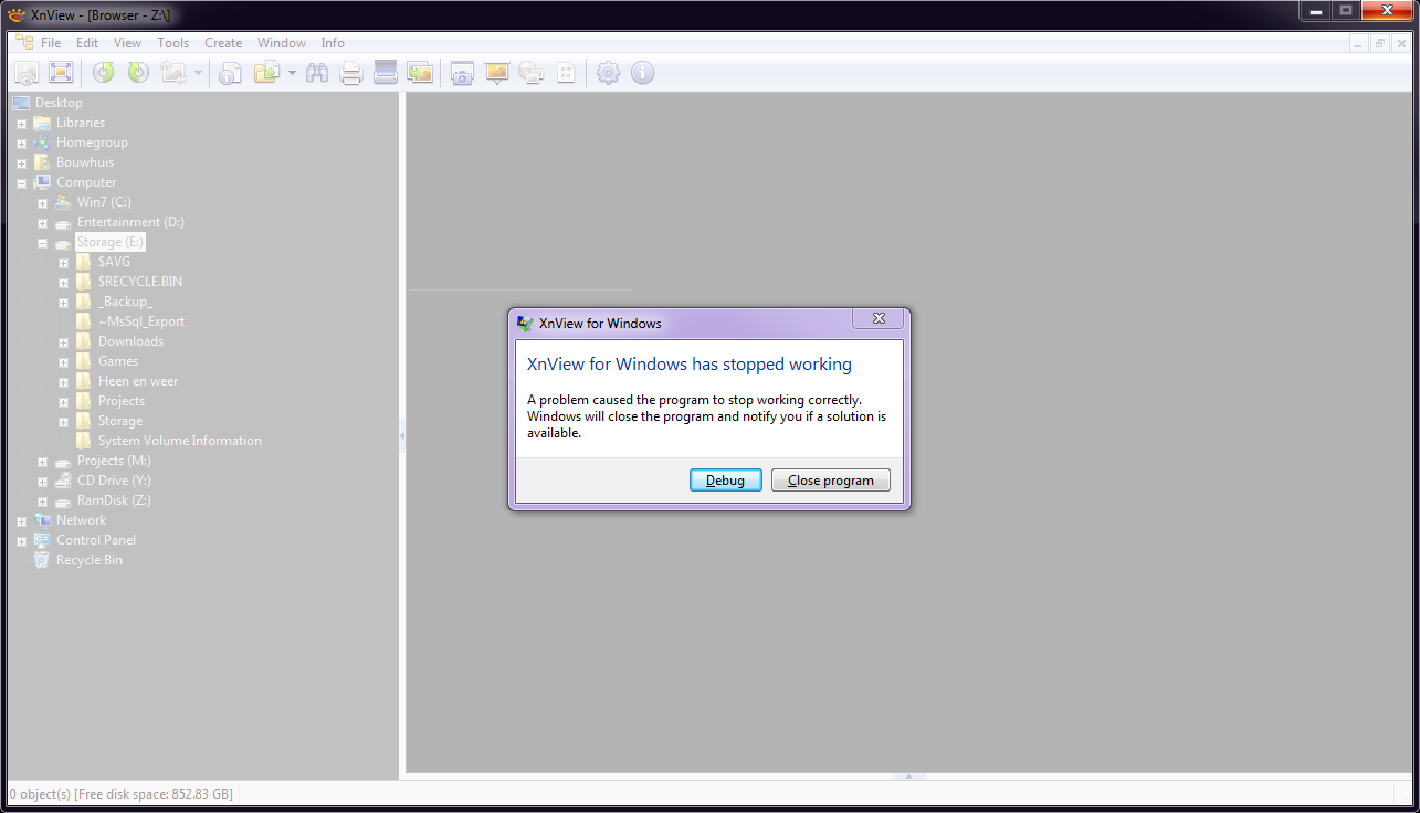

Edit:
Ok, found an old 7z.dll (I installed XnView in a new directory).
It's still not working. I now see the files in the 7z archive, but XnView crashes when I try to show a picture. (see attachment).
This is really frustrating.

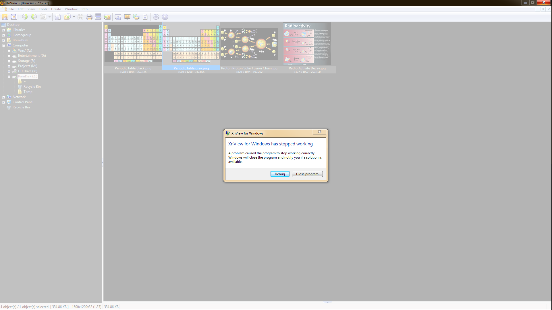

Re: [v2.24] Can't view picture when inside an archive
Post by iycgtptyarvg »
Same result:

omniplex
Posts: 127
Joined: Thu Feb 10, 2011 1:52 pm
Location: Hamburg
Post by omniplex »
iycgtptyarvg wrote:Same result:
Works for me, wild guess: We both tried to be smart and replaced the 56 KB DLL by something that's fresher than 2006. Doesn't work, and at that point I simply ignored the issue. When you reverted your DLL to the 56 KB DLL it still didn't work, and Pierre posted an archive with even older sqx20 + UNACEV2 DLLs.
In those attempts of trying to be smart I had deleted both years ago, because I've never seen any ACE in this millennium, and I've never used SQX by the Speed Commander project. But maybe the old 7zip DLL needs the old sqx20 + UNACEV2 DLLs for its own initialisation, therefore I added both, tested your test archive, and it worked for me. :bugfixed:
