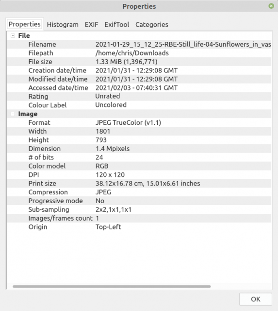

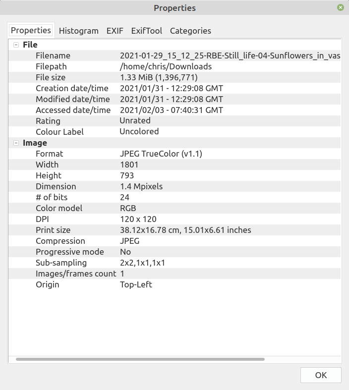

Well, why do I consistently get a different result without 'estimated quality':
Could I have a copy of your version of XnView MP 0.98.1 please?
Seriously, there must be an explanation...

cday wrote: Wed Feb 03, 2021 4:12 pm Could I have a copy of your version of XnView MP 0.98.1 please?
I use the current package. in settings>Format>Write>JPEG - estimated is checked?
Posts: 4601
Re: Display JPEG quality / compression level in info box
xnview wrote: Wed Feb 03, 2021 4:23 pm I use the current package. in settings>Format>Write>JPEG - estimated is checked?
In the editor File > Format settings... > Write tab -- JPEG -- Use estimated quality... wasn't checked, but checking it hasn't changed the information displayed... :(
But that is a write setting and shouldn't be relevant to reading the parameters of an opened image...
And there surely shouldn't be a difference between one of the displays of image information, and the other two displays...
