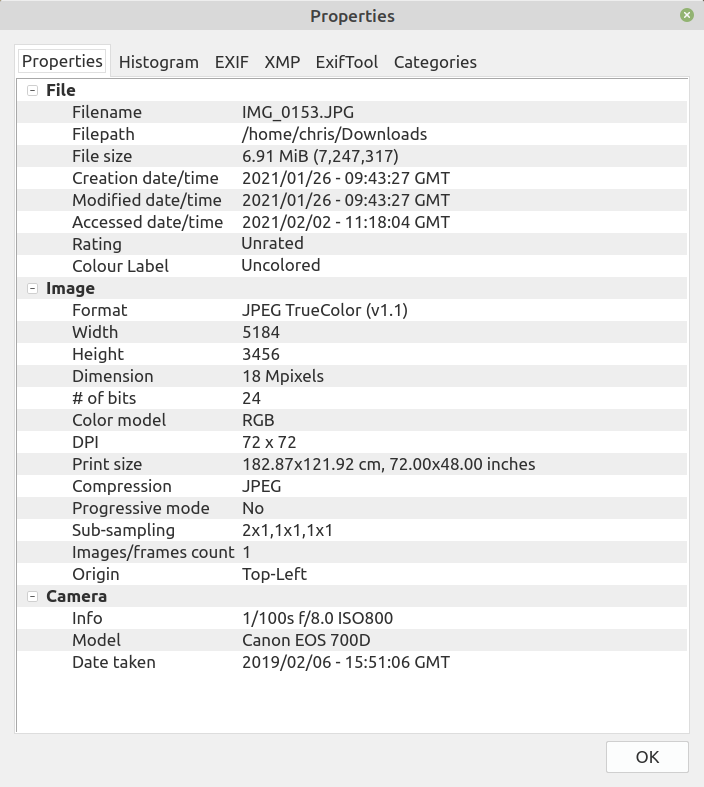

That is exactly the problem and it continues to be a serious inconvenience :( :

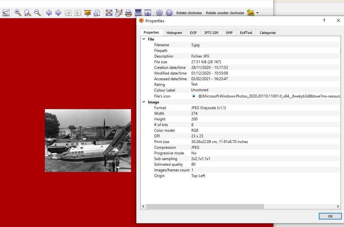

i've tried with 0.98.1, and i have 'estimated quality' in browser and viewer

xnview wrote: Tue Feb 02, 2021 1:06 pm i've tried with 0.98.1, and i have 'estimated quality' in browser and viewer
OK, the problem is that Edit > Properties... shows 'estimated quality', but clicking on the toolbar 'I' icon opens the display above where it is not included...
That's what I always use as it is more convenient, but at least the issue is now identified and can be corrected. :D

Not for me, I posted a screenshot above, could you check please...
Steps to reproduce:
Open a JPEG in the viewer;
Click on the Toolbar 'I' 'Properties' icon.
'Estimated quality' is not displayed.

Any way: From the browser, from File > Open... in the viewer: never 'estimated quality' from the 'Properties' icon on the viewer toolbar... :(
Steps to reproduce:
Open a JPEG using File > Open... in the viewer;

Re: Display JPEG quality / compression level in info box

That is the result of using Edit > Properties... :wink:
The result using the 'steps to reproduce' above is different: it does not include the 'estimated quality' term.
From here in the Royaume-Uni Libre, it seems clear that different code is used by the toolbar 'Properties' icon from that used by Edit > Properties... and the browser.
Using the code used by Edit > Properties... for the toolbar icon should resolve the issue, and also slightly reduce the 'weight' of 'MP... :wink: :D
