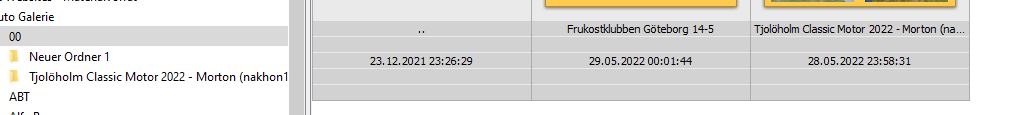

Have we got now a video? I have no software for doing this.
Here again: right side: created a new folder, left side: it shows new folder but not the name. Now I need again to print F5.
That should be enough to reproduce it.

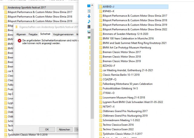

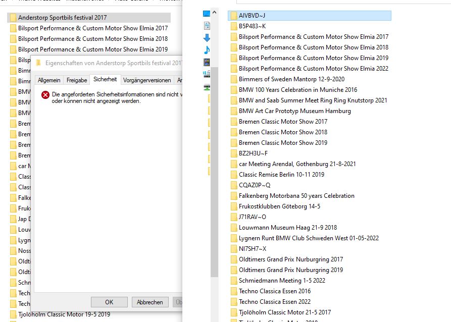

There is another issue, which is created by XNview since several months.
Left side is the local hard disk. Right side the network drive for the backups. Often you will see not the folder names, but instead the short DOS names. This is happening, when the folders are created in XNview (in this case last night), then synced to the backup. Some folders, not all and not replicable when and why - are getting security problems with the owner. This cause then the shorter names on the backup drive. The only way then is to manually delete them by rmdir in DOS prompt window and create the folder new in Windows explorer and move the files inside to them.
I know this is tricky too now for you, but I think it could come from the same grounding problem with the rights. I have only my 1 user here with admin rights.
