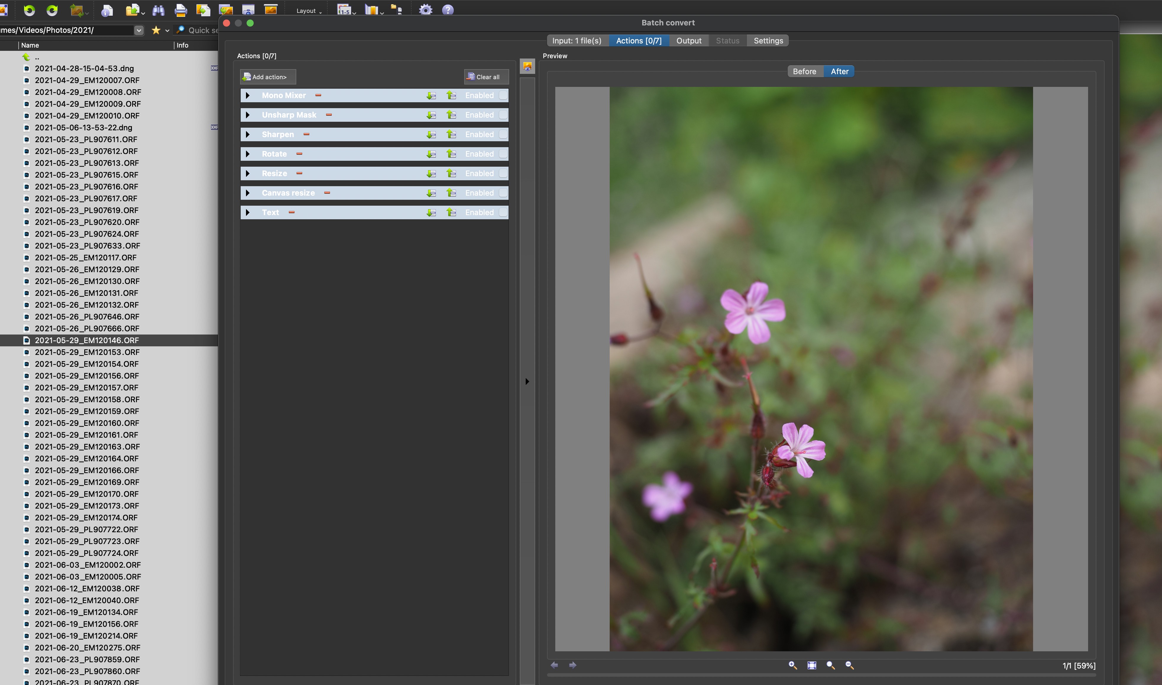

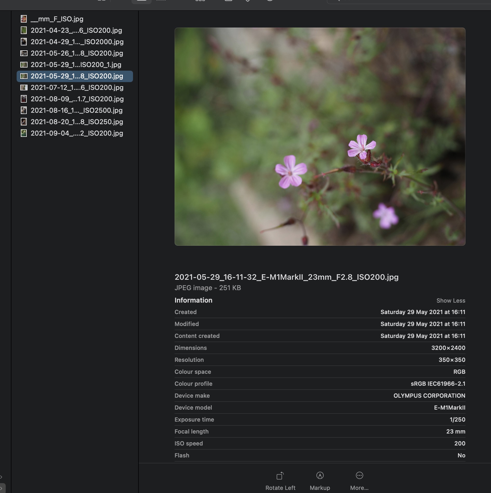

I'm still having a problem with output rotation in a batch convert. My RAW Olympus E-M1 mark ii (.ORF) portrait photos are not rotating on batch convert to jpg. Not sure why. The photo displays fine everywhere EXCEPT on batch export (finder, inside xnview, etc.). I'm currently running the latest version of .99.1 on a M1 iMac in Big Sur. I've attached screenshots for you to see. Is this still a bug? What can I try (I have thousands of photos)?

After more research, it would seem ALL ".ORF" files (from Em1 ii, E-PL9, and E-P7 tested) batch export wrong when photo was taken in portrait. When converted to ".DNG" before export, they do fine. Is there some way to add this support?
- Posts: 49081
Re: XnView MP 0.90 Rotate Bug
It's a known issue, will be fixedJohn_Matthews wrote: Wed Oct 27, 2021 5:32 am I'm still having a problem with output rotation in a batch convert. My RAW Olympus E-M1 mark ii (.ORF) portrait photos are not rotating on batch convert to jpg. Not sure why. The photo displays fine everywhere EXCEPT on batch export (finder, inside xnview, etc.). I'm currently running the latest version of .99.1 on a M1 iMac in Big Sur. I've attached screenshots for you to see. Is this still a bug? What can I try (I have thousands of photos)?
