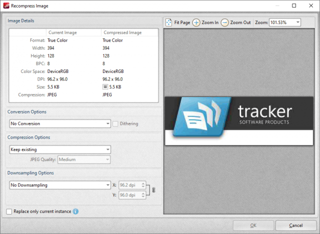

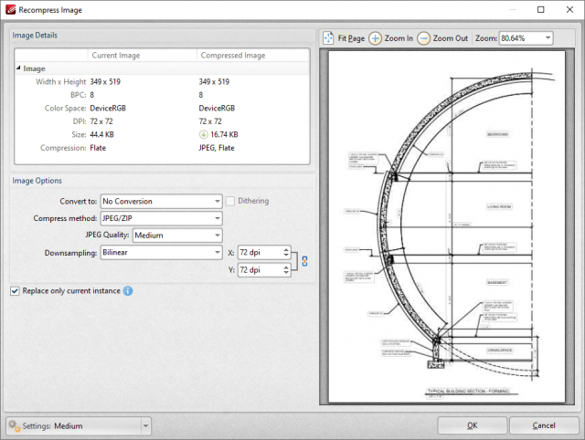

IxenPDF wrote: Thu Apr 01, 2021 7:35 amSo how can I find out the real properties of my pictures that are in my pdf? Is there any third party tool, that can do this?
Command-line tool: Poppler for Windows
XnTriq wrote: Tue Feb 21, 2017 6:00 pm
pdfimages.exe -list 'Das_erfolgreiche_Bewerbungsgespräch-72 s-w extr 11.pdf' wrote:
page   num  type   width height color comp bpc  enc interp  object ID x-ppi y-ppi size ratio
   1     0 image     550   851  gray    1   1  ccitt  no         3  0    72    72 12.9K  23%
   1     0 image    2835  2209  gray    1   1  ccitt  no         9  0   300   300 71.9K 9.4%
GUI: PDF-XChange Editor
