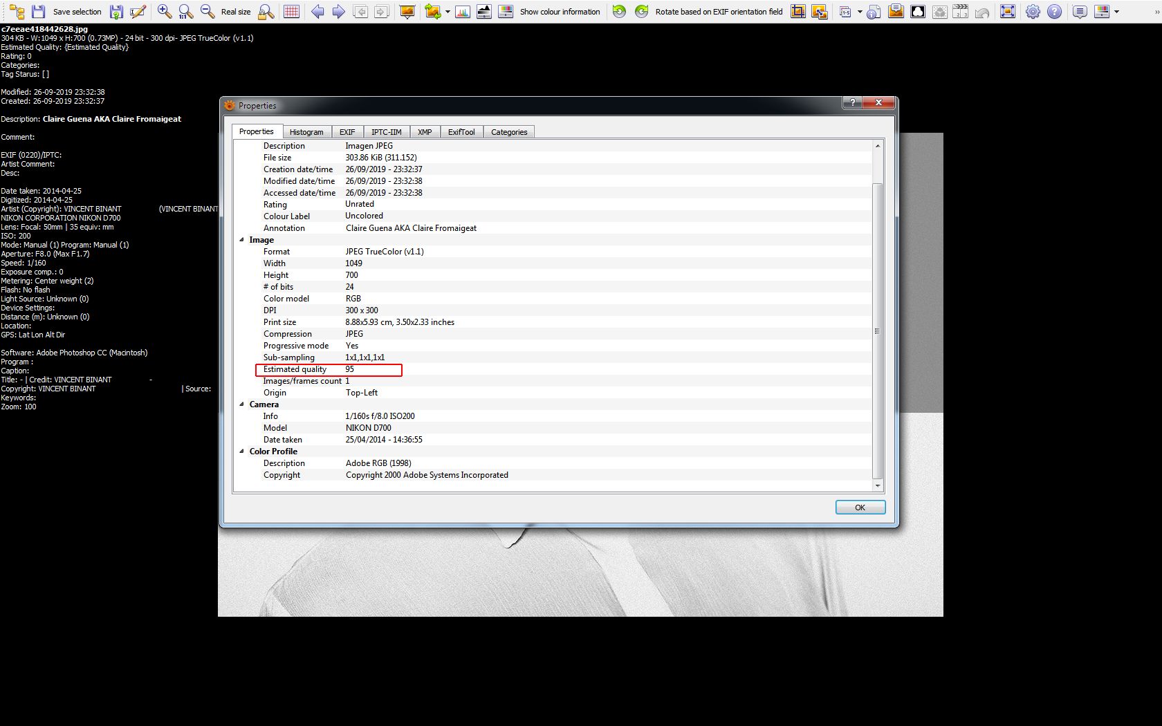

Re: Display JPEG quality / compression level in info box
I just installed 0.98.2 x64 on windows and the problem still exists as you can see here, the Estimated Quality is reported in the Properties dialog but not through the codes to display info on image viewing screen (Show Information Icon). As you may see I did configure a pretty complete Information area while viewing in the Settings|View Info tab to save time.
Do maximize the image to see capture in good definition.

- Posts: 4623
I thought the reason for the viewer Properties (i) toolbar icon not displaying JPEG 'Estimated Compression level' had finally been identified and fixed, but evidently not, and the information is still not displayed in 1.00...xnview wrote: Sat Feb 06, 2021 1:03 pmHoura Thanks XnTriqXnTriq wrote: Fri Feb 05, 2021 2:00 pm
- Disable the catalog.
- Go to a folder you haven't browsed before.
- Open a JPEG in fullscreen mode (F11).
- Move the cursor to the right edge of the screen.
Estimated quality is present in the Properties pane.- Go to the next JPEG (PgDown).
Estimated quality is missing in the Properties pane.i have it, bug.
