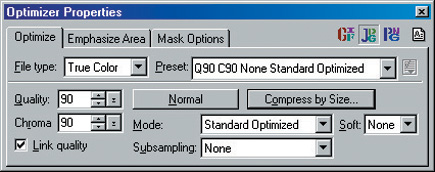

Troken wrote:Is it possible? Is there any way to see what quality the JPG was saved with?
- photo.net
- Jpeg Compression Introduction » Jpegdump
A utility written by Allan Hessenflow (with modifications by Tom Lane) allows examination of actual Jpeg data. It has outputs that estimate the IJG quality settings for any given Jpeg. When used together with an IJG compression utility this allows almost exact recreation of a Jpeg. The only versions of this utility that I know of are source code and command line executables, so they are unlikely to be of direct use to the general public. It would be most useful for Jpeg writing software to list the prior quality level so you could rewrite (if necessary) at the same level.
- Programmers Heaven
- Dump JPEG marker information / Jpegdump.c
Enclosed are C source code and a DOS executable for jpegdump, a JPEG file inspection program, which will print basic info about each file (image dimensions, quality setting, sampling ratios).
- MediaChance
- jpgQ – JPEG Quality Estimator
What is the quality of JPEG already saved on disk? This small free software applet will estimate the quality of the JPG image. This is also the quality you should use if you load this image again in the photo editor (such Photobrush) and then re-save as JPG once again.
- Pegasus Imaging
- Compression / Recompression Optimization
This feature uses advanced techniques to completely avoid generational loss caused by recompressing images. Unique technology minimizes JPEG artifacts by performing various image editing operations directly on compressed JPEG data without decompressing and recompressing files. This specific JPEG optimization does not uncompress then recompress to shrink JPEG files, as do all other so-called optimizer schemes. Recompress JPEG images with no additional loss than if you had started with the original image. Simply use the compression and editing features found in The JPEG Wizard and the compression utility found in the Online JPEG Wizard to see the results of Pegasus Imaging's research into this technology.
- http://www.efuse.com/Design/graphics_pr ... SmartSaver
- http://www.shutterbug.com/images/archiv ... eadi02.jpg
- http://docs.rinet.ru/RabotaPauka/f10-5.gif
