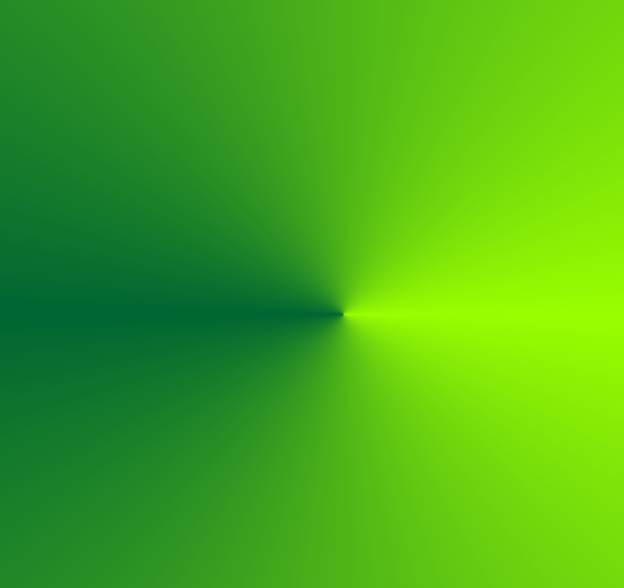

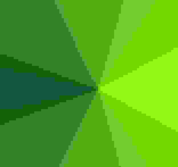

Below a sample file which impressively shows how JPG compression can fail when re-saving a compressed JPG image:
Image saved with JPG compression (6 KB):
Same image saved again with JPG compression (6 KB):
foxyshadis
Posts: 395
Joined: Sat Nov 18, 2006 8:57 am
Post by foxyshadis »
The second one has a thumbnail and some IPTC junk, it looks like; the actual image data is only 3.1k. Like most programs, I usually have to run a jpeg optimizing step after saving in xnview. :(
