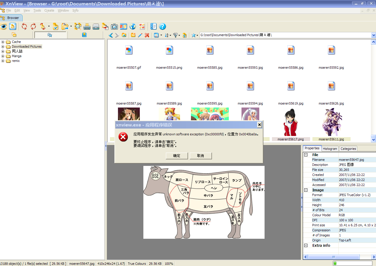

I can't stop Xnview hang in viewing my some moe collection folders.
I think I have reported same problem one year ago from 1.90 beta.
same problem occured in clean install of windows server 2008.
hardware DEP disabled in BIOS settings, and software DEP only applied to system modules.
2 hours earier I start debuging Xnview and found some diffrent hang have little same rulz,
I hop you can make sure some problem exists.

open xnview, click browse, and select my folder "moeren", drag scroller to end.
then I can do nothing but wait it hang in diffrent address.
when exception/access violation dialog popup up, I can still drag the scroller on right and the content can scroll as well.
here I attached an screenshot of crash.
the folder contain 13188 pictures, mostly jpeg, some gif/png. If I wait the progress bar (thumb geration) run to end or press Esc to cancel geration before click any image, xnview.exe will live longer.

I can reproduce the problem quickly by followed steps:
start xnview,
click browse to select an floder that havn't any image,
then use favorites tab to browse target folder,
scroll to end and click an image near end,
wait some seconds, xnview crash.
If I directly use browse to open target folder, or check "Launch browser at startup", it will take me more than 5 minuts to wait xnview get responable, sometimes may hang in half.
if I do not click any image, its will crash later more than 1 minutes.
the action "scroll to end" and "click an image before thunbm generate done" helps me reproduce the problem ealier.
lots of image in folder helps me make the thunmb generate slower 8) or I will have no chance to oprate after it refreshed done.
if xnview.exe havn't crash before all thunmb fetched, mostly I can view pictures onby in _that_ folder freely more than five minutes or upon to half hour, otherwise I will get access violate quickly.
sometimes it have access violate crash while I browse between lots folder have only handred pictures in it.
but mosttimes if I browse between more than one folder each have ten thousands images, It will hang without any suspect.
in past 1.91.3 tests I disabled muitli processor support in boot.ini (/NUMPROC=1), xnview runing much stable and only crash rarely.
but if I use PEEditor to make OS only assign a cpu for xnview 1.91.6 (No muliprocessor systems in characteristics), I can see only one cpu grabbed by xnview but it still crash as often as unchaged executeable.
1.91.3 looks can keep alive longer if I disable one cpu for xnview process in windows taskmanager.
I disabled xnview cache generation because It's unaccessable for my folder.
I also disabled "lanuch bwoser at startup" yesterday for that test.
1.82.4 never crashed at sametime I testing 1.91.x
I always using 1.91.x with crash -> launch -> crash circle because tree view in 1.82.4 takes me spend more than five minuts to get it unfreeze.
I have remote debuger server from visual studio 2008 installed on my working system, or I can offer msvcmon in vc 6.0 on alernative clean windows server 2008 installion on same box.
I can calculte source line number If I have an release version exe and corresponding map file.
can you please allow me to help the xnview?
