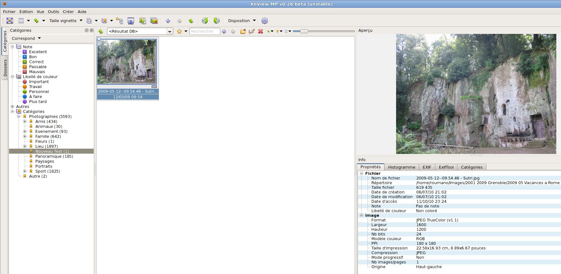

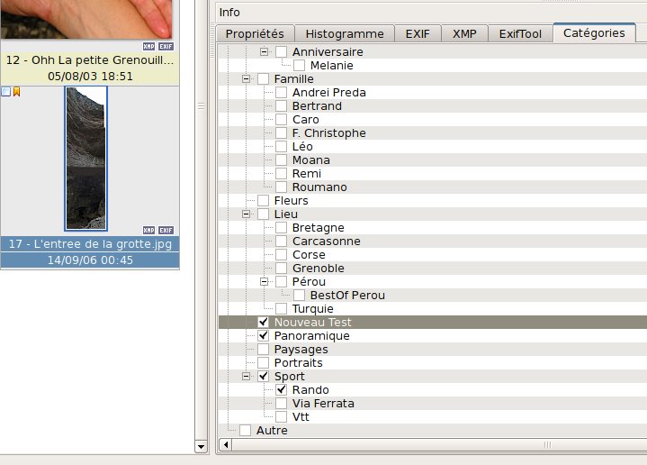

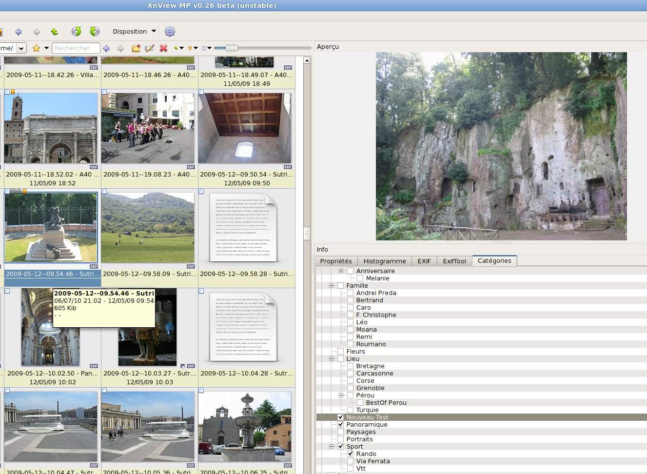

I have play with this bug :
I can't reproduce this exactly as XnviewMP is no more crashing.
But, we can always reproduce this :
1) On the explorer view, select one (or more photo) which is contain the caractere '
As my first screenshot. Add a categories (i have tested it with a empty categorie)
2) Open the Categorie view, open this new categories (normaly contain only this photo) :
You will found on the categorie, a 'random' photo ! as my second screenshot
3) To play again with this bug on the database : go on the explorer view and found the 'random' photo :
- The thumbail and categories of the file is appartening of the image which is contain the caractere '
