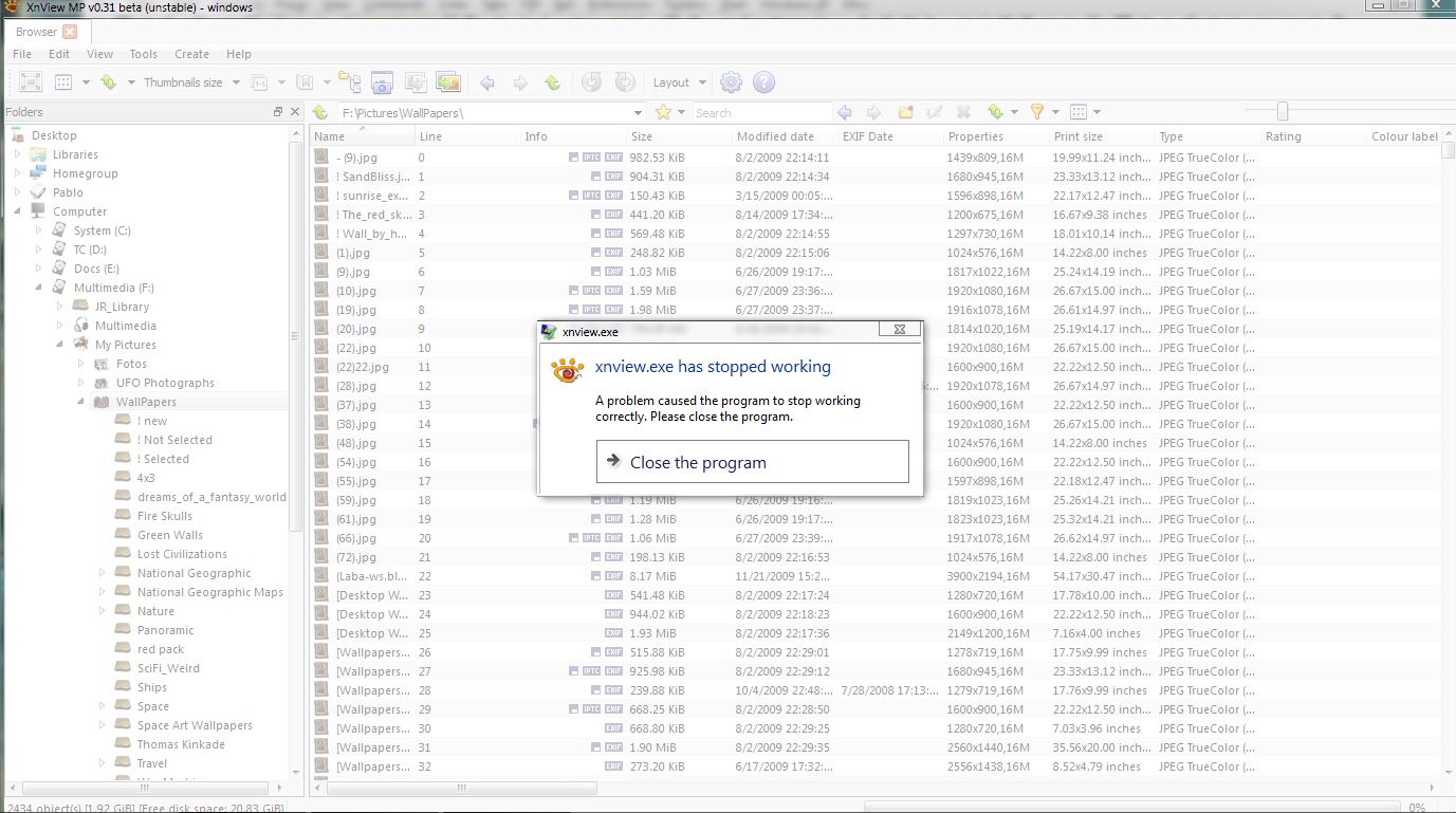

ElQuia
Posts: 42
Joined: Fri Oct 22, 2010 2:19 pm
Location: Córdoba, Argentina
Re: MP 0.31 Crashes
Post by ElQuia »
marsh, hangs even in detail view. Attaching screen captrure and ini file that matches.
:evil: :shock: :( :( :(
