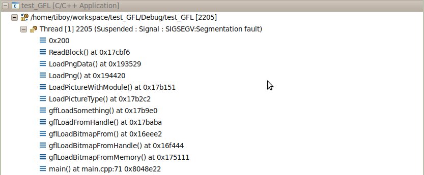

tiboy08
Posts: 10
Joined: Tue Feb 15, 2011 6:56 pm
Re: gflLoadBitmapFromMemory problem under linux ??
Post by tiboy08 »
Here is the stack trace from my debugger ...
