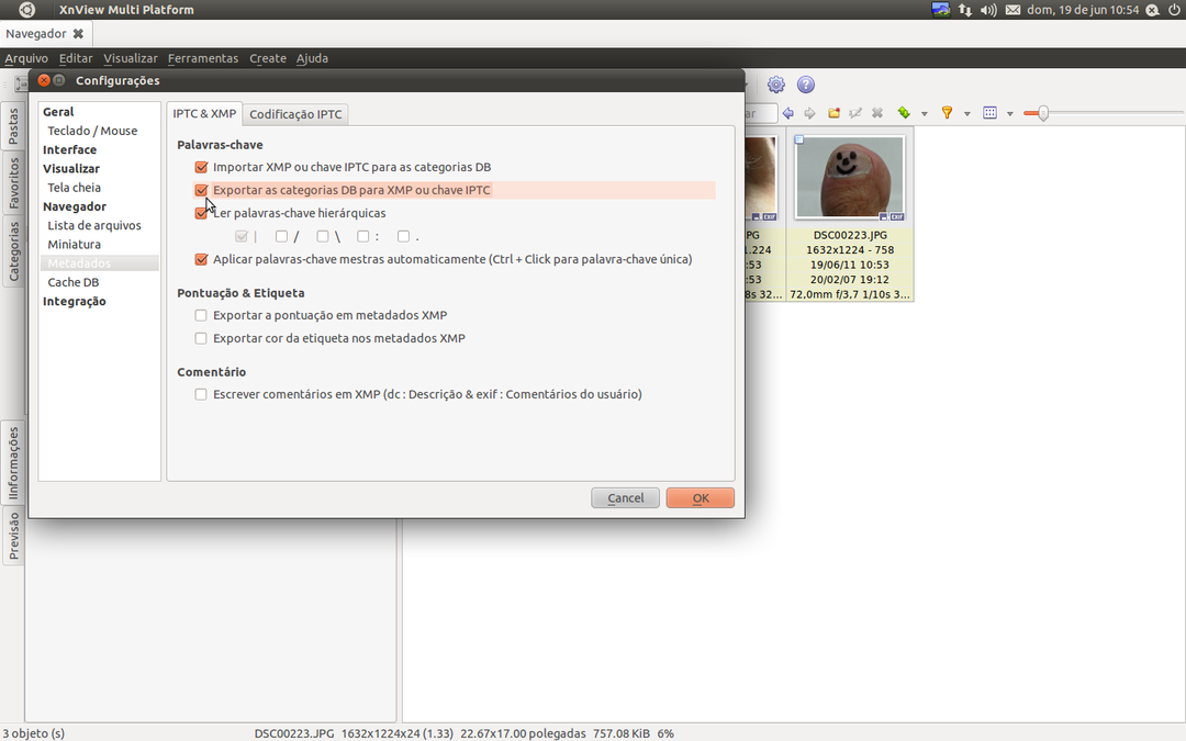

Step 1: Enable "export categories to IPTC or XMP":

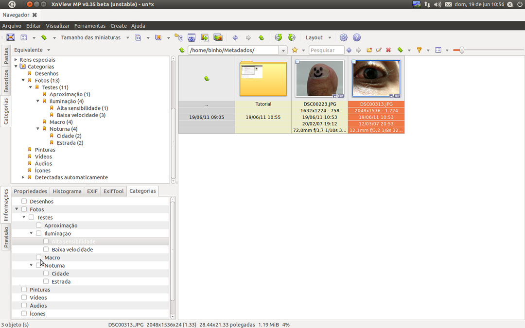

Step 2: Select the categories that usually want.
It has no category:

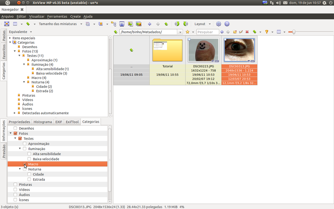

Selected category "Macro", XnView MP automatically selected "Test" and "Fotos":

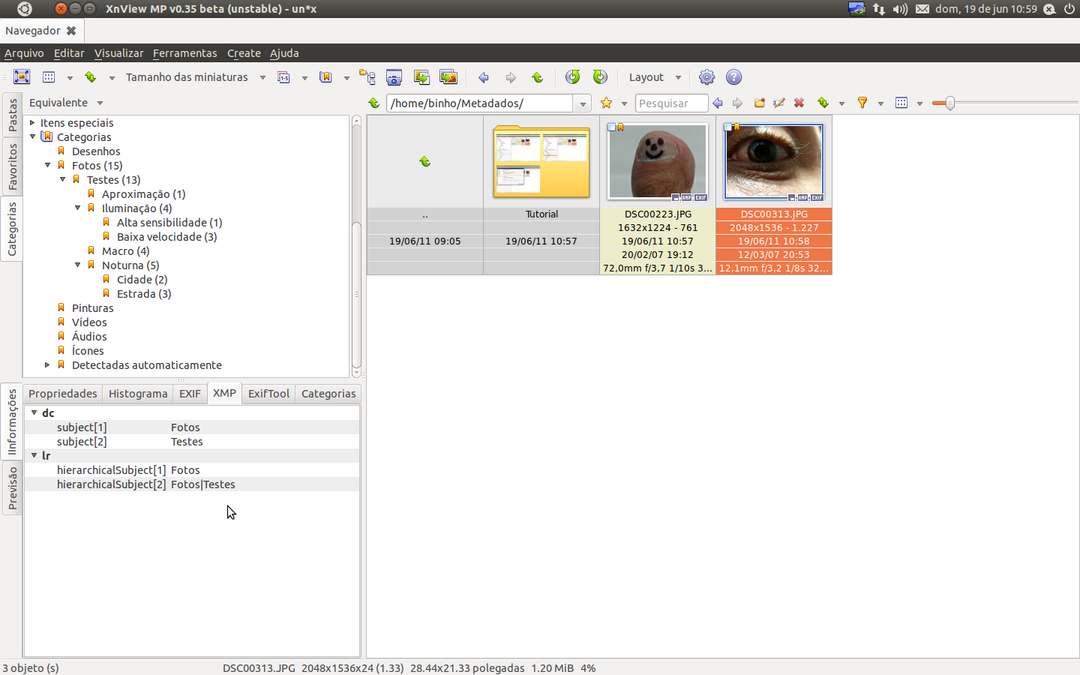

Step 3: checking, sometimes, XMP is incomplete:

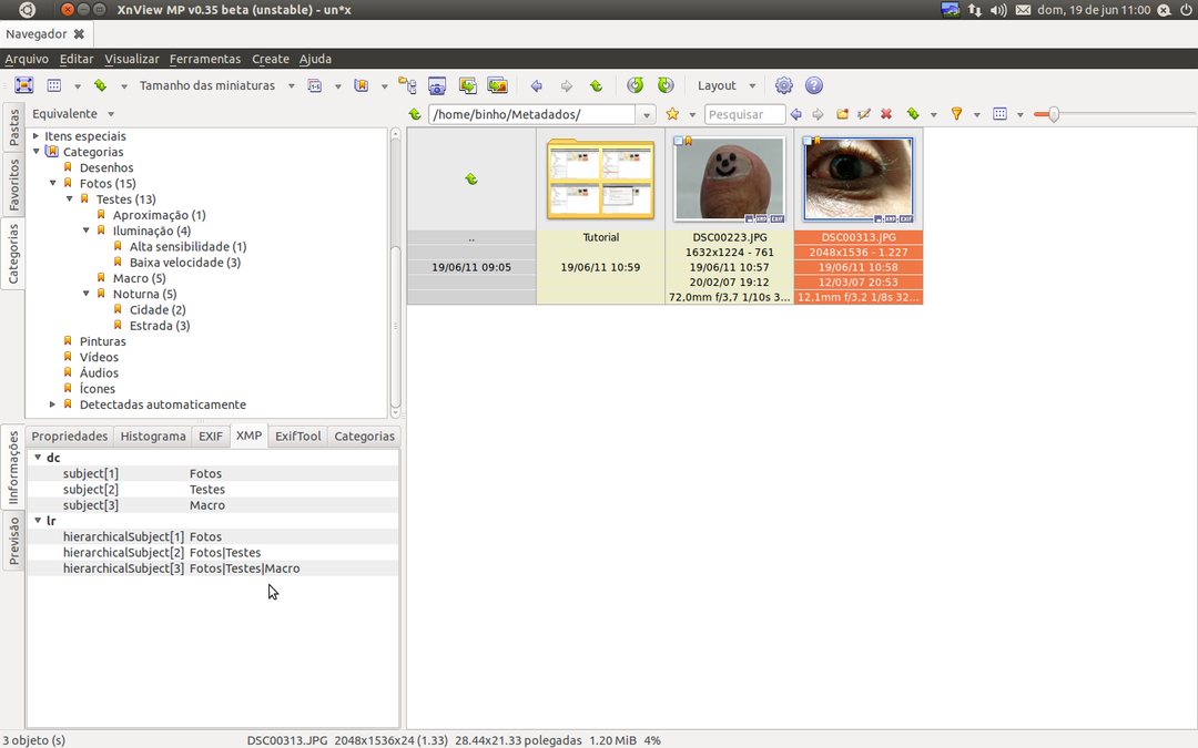

Step 4: correcting; nomavente after selecting the category "Macro" in the dropdown menu (I could not capture the screen, but just right click on the photo), XMP is complete:
