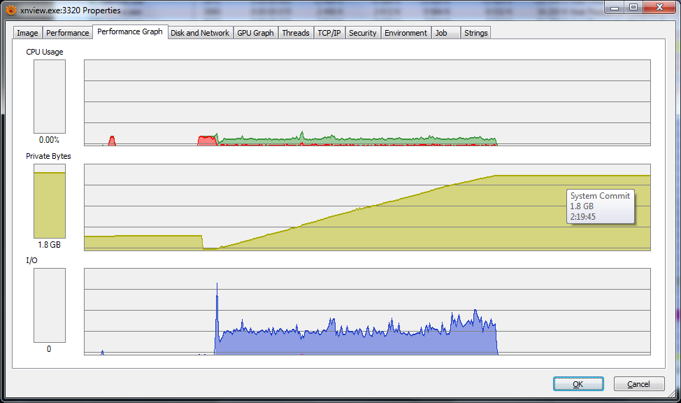

A linear increase in memory usage when generating thumbnails. And predictable error at 1.8 GB. :(

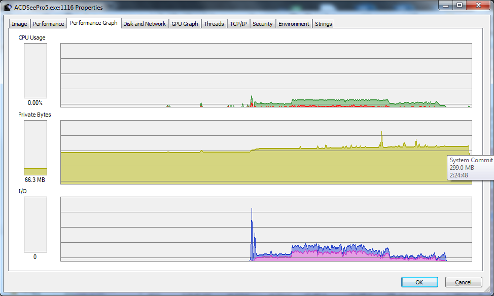

For comparison, ACDSee 14/Pro 5 memory usage in same folder is not a linear, with maximum of 300 MB:

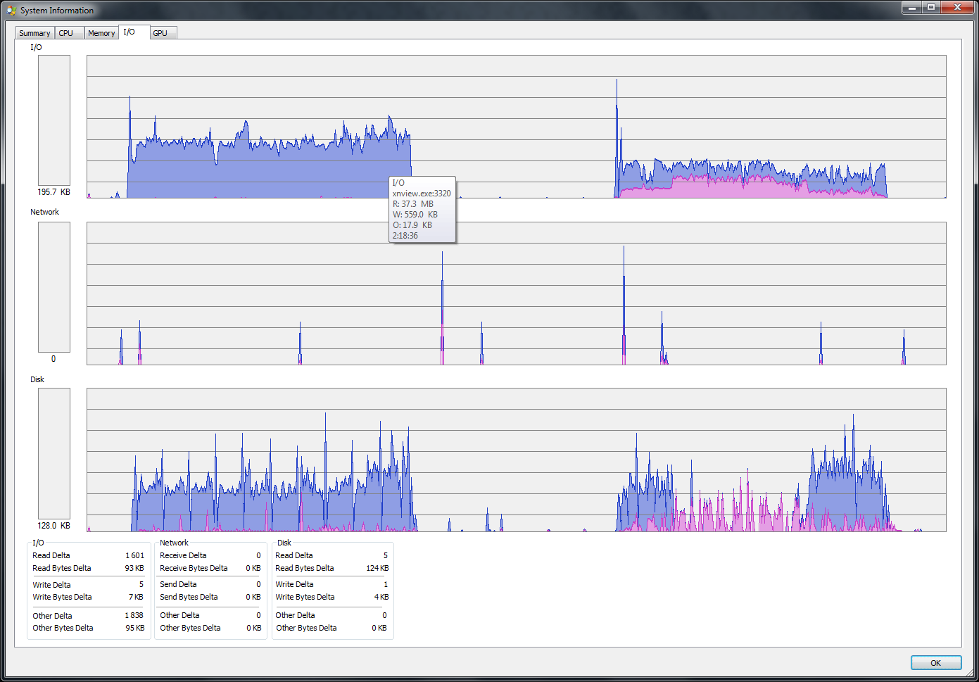

Also, comparison of the total load - on the left side XnViewMP (before the error), on the right side ACDSee (successful thumbnails creation). Here you can see that XnViewMP writes nothing to disk, use RAM only, and then crashes. :|

But this does not remove the high memory consumption.
Also, when you return to the folder with thumbnails, XnViewMP need a LOT of memory again...
Perhaps XnViewMP loads ALL thumbnails for current folder from cache to RAM, which is somewhat wasteful... :(
Maybe this leads to delays with file opening (http://newsgroup.xnview.com/viewtopic.php?f=60&t=25863).
Posts: 47878
Re: 0.49 - crashed at 1.8 Gb RAM limit
Yes, so you need to disable 'create for whole folder'
