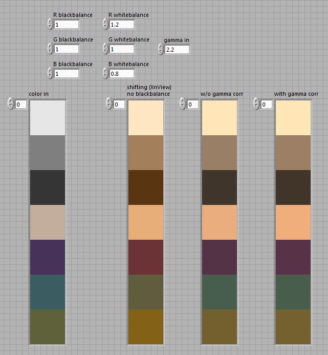

I know "officially" you should apply the multiplication on the gamma uncorrected values, but even if you don't do that the results are a lot better than when simply shifting. The dark colors will be preserved much better.
I've done a little programming to show the difference between the current method (shifting), the direct-multiplication method, and the gamma corrected multiplication method. See attached picture. The calculations are performed on the colors in the left array, and the ones on the right are the results when performing the color correction shown on top (R: 1.2, G: 1.0, B: 0.8). With the shifting method, you can see the red shining through on the darker colors.
Regards,
Joris
EDIT: Gamma correction in the picture contained a mistake
