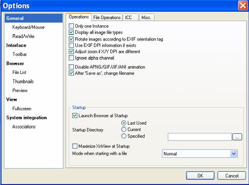

AutoSketch SKFs are displayed in the browser, because XnView is natively (= no plug-in needed) able to extract embedded (low-res) thumbnails from this format. What I don't understand is why DXF files are hidden
Is Display all image file types (Tools » Options... » General » Operations) activated?

True...I do not show dlls under Tools>Plugins... all I show there is FTP(1.05) & CD(Nero)(1.0)
& yes,
'Display all image file types' is checked under Tools>Options>General>Operations. There must be an option somewhere that is preventing XnView from even recognizing they are there.
It's probably something really simple, but since I'm not familiar with XnView, I just don't know where to look (or what I did)

Actually yes, the DXF files do show up when I change the setting to Filter by all... I had it Custom. (see it was somthing I did!!) PROGRESS!!
YES!!!
And now it wants me to purchase the CAD Image DLL to remove the overlaying writing... I wonder how much that costs!! (I'll worry about that later... if the rest works as I hope... )
