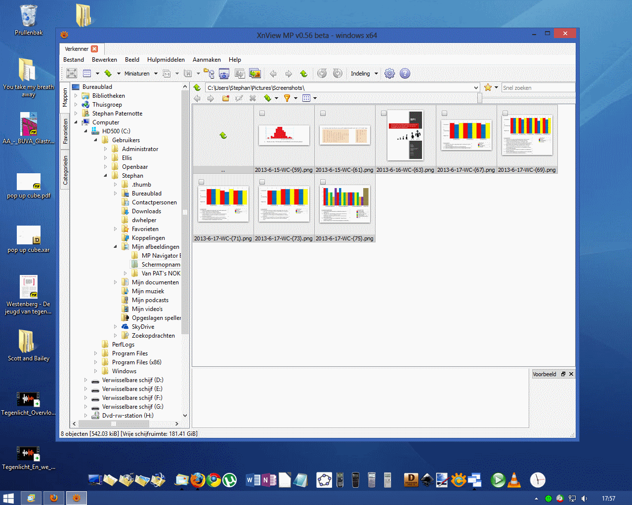

I did another experiment and there's definitely something off.
Take for instance attached screenshot.
If you open the file in yet another paint app, then you can determine that cropping the XnViewMP window will require the following crop values:
Top: 56
Bottom: 129
Left: 112
Right: 107
Now, without the above knowledge, use the crop preview and try to set the crop values, cutting out the XnViewMP window in the middle of the screen shot.
In this process, there'll be some increasing/decreasing of values on the left, clicking the "apply action" in the middle and zooming in/out and panning on the right.
At some point you may notice something strange happening to the picture, but then again you may miss it altogether as well.
Anyway, when you think all valueas are correctly set, then you may find that these do not correspond to the above mentioned values.
And if you actually perform the action, the resulting image will have an offset and the crop is not made as intended.
Top: 56
Bottom: 129
Left: 112
Right: 107
- Posts: 48925
Re: 0.65 - W8/x64: Batch convert - crop preview is wrong
If i enter these values or use slider, the result is good in preview and output
