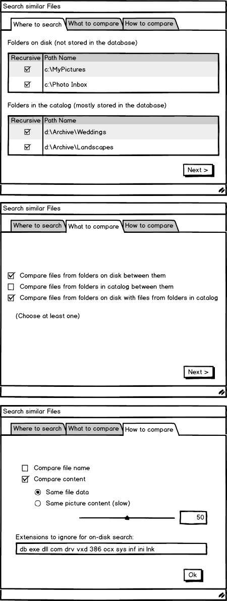

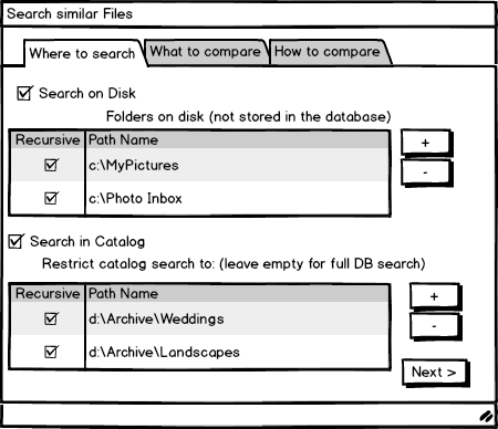

Add two check-boxes ("Search on Disk" and "Search in Catalog") on 1st page and hide the lists of folders. The lists will became visible when the corresponding checkbox will be checked:
Besides of having a much more clean landing page (which will help in user's experience) we can hide the second tab (called "What to compare") and show it only when both checkboxes will be checked.
In this way the workflow will be more streamlined.

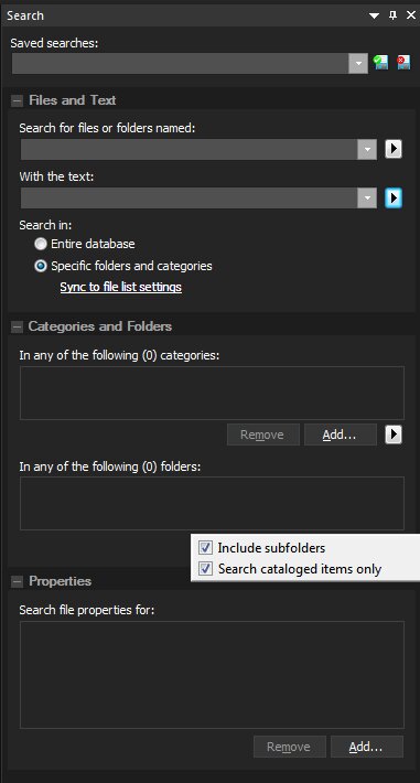

Another missing bit - which is important also for the main search engine: Search only in database. This will speedup the things a lot because the program will not need to search in un-cataloged folders anymore. This complies with the common practice among eg. photographers (and not only) which have a static archive which doesn't change. In this case, any disk fallback in searching of potential new/changed items is a waste of time.
Of course this must be optional because there are cases in which one does not search in a static file structure.
Here is how ACDSee implements it: (scroll to see the white popup menu)
