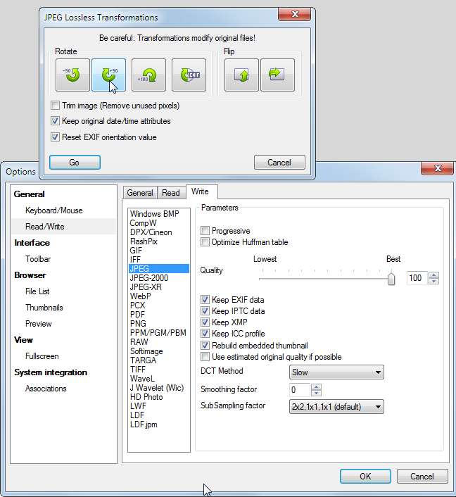

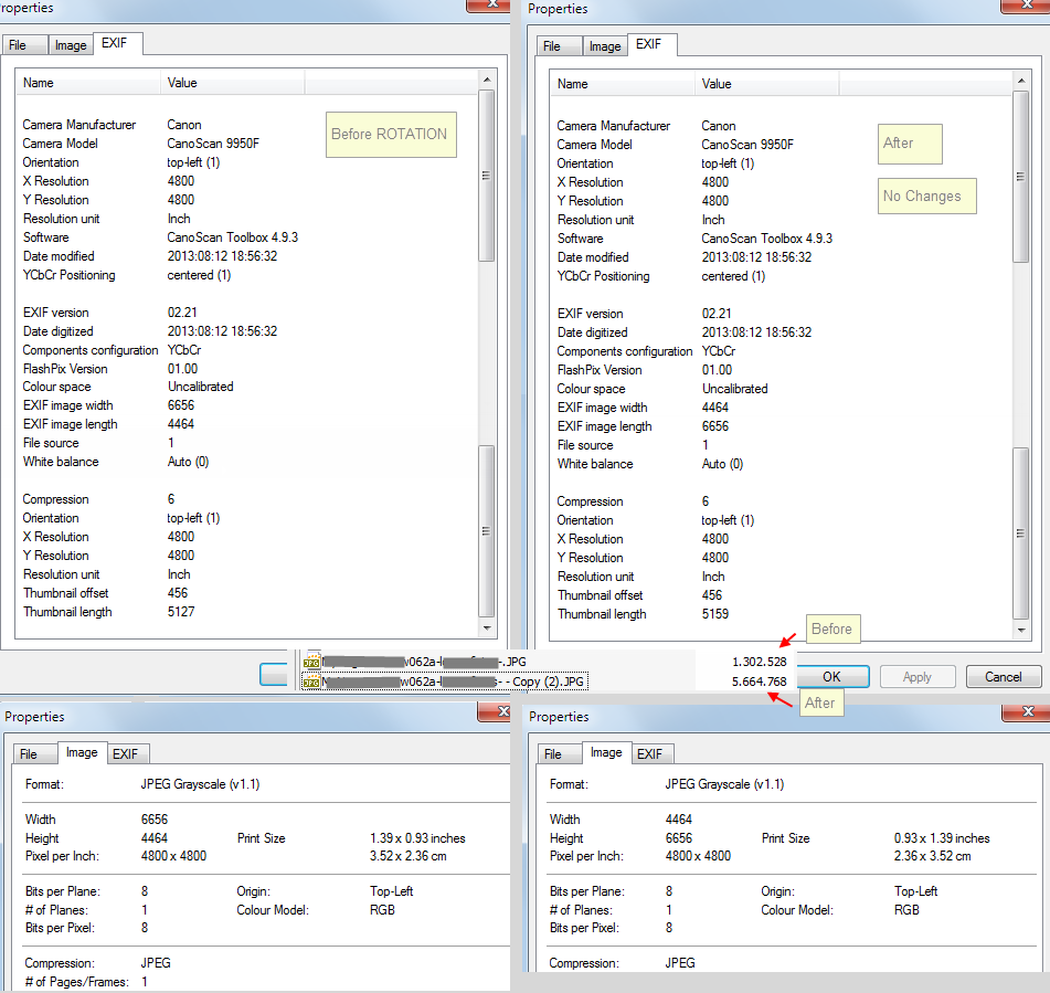

When I rotate an image, the size is by about 4x as large, i.e. a 1.25MB image increases to about 5.5MB
How come?
That aside, wonder how much the photos degrade in quality.
(jpg)
Oh, If this is done with PNG how would that work out - I have no way to test it, question is more out of curiosity.
Thanks
later .. example
with these settings:
results:
no changes, only the file size
filesize from 1.3MB to 5.6MB

mrwul wrote:When I rotate an image, the size is by about 4x as large, i.e. a 1.25MB image increases to about 5.5MB
1. Used "ordinary rotate" and resaved, rather than lossless JPG rotate ?
2. JPG ?
> How come?
Expected effect. The new JPG was saved with a higher quality setting than the original (bad idea).
> That aside, wonder how much the photos degrade in quality. (jpg)
Expected effect. JPG is lossy. Resaving will always degrade quality, even if the new file is bigger.
Lossless for 90 degree rotations.
