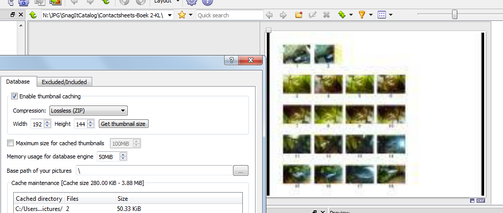

Please check thumbnail size stored in database in Option>Database
mrwul
- Posts: 347
Re: XnView Database- and blurred thumbnails questions
You mean here?
Pls cud you advise what settings I should use there?
Am really uncertain.
I just unpacked XnViewMP again, so this is pretty much default.
Thanks.
Thanks.
m.Th.
- Posts: 1676
YES!You mean here?
For dummies: Put Width 300 and Height 200
- or -
For smarties: Fix your thumbnails as you want. Perhaps make them a little bigger than you want. Press in the same window the "Get Thumbnail Size" button.
Also, compression is enough to have 'High Quality JPEG'

m.Th.
- Posts: 1676
You mean like this?
Bravo!!!
m. Th.
