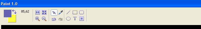

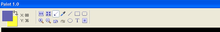

Misleading toolbar icon for moving
A short while ago an XnView user asked me how to draw arrows and text on an image. I told him about the XnView Paint tool. He did download the Paint tool but he wrote that he failed in adding an arrow. I've just tried the Paint tool and by now I know what the users problem was: A misleading toolbar icon.
The toolbar icon for moving existing objects is an arrow. This makes people think that they can draw an arrow when clicking on this toolbar button, which is not the case. This toolbar button is for selecting and moving objects. I strongly suggest to change the icon of the toolbar button so that users can clearly see that this toolbar button is for selecting and moving objects.
Original:
Misleading icon - current.png (5.62 KiB) Viewed 880 times
Suggestion with different icon:
Misleading icon - Suggestion.png (5.73 KiB) Viewed 880 times
Toolbar separators
Currently, the toolbar is not structured very well. The toolbar buttons should be grouped:
1 - Zooming (Buttons: Original size, Fit to Window, Zoom in, Zoom out)
2 - Drawing (Buttons: Draw line, Draw rectangle, Draw round rectangle, Draw circle, Add Watermark)
3 - Editing (Buttons: Undo, Redo, Color information, Move)
(see draft above)

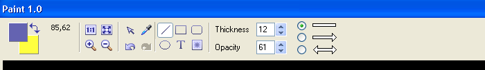

Line / one end Arrow / Both end arrow
Currently you have two checkboxes for setting the ends of the lines (nothin, arrow at end, arrow at begin and end). It's not that intuitive that you have to uncheck both checkboxes to draw a normal line. Instead, there should be three checkboxes.
Line types - Suggestion.png (8.23 KiB) Viewed 880 times
