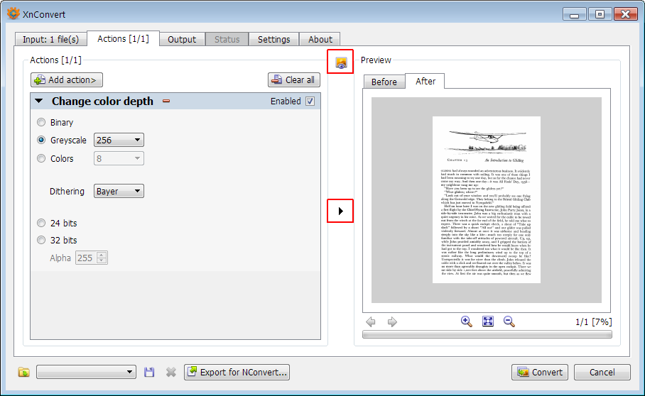

- Posts: 4612
Re: Grey scale
I have also sometimes found previewing the effect of actions confusing and that some trial and error was necessary.Allen76 wrote:I thought this would be easy, something is amiss.
When I go to “Actions” the photo is not there.
The two buttons outlined in red in the screenshot are both unlabelled but do have tooltips: 'Apply actions' for the lower one and 'Update preview' for the higher one.
I've also found that for some actions the preview seems to be updated automatically when parameters are changed, but for others or in other circumstances it is necessary to update the preview manually.
I think the interface design could possibly be more intuitive -- but I don't have any immediate suggestions for how it could be improved -- so I would suggest some more experimentation...
