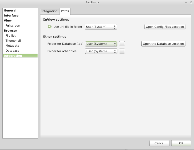

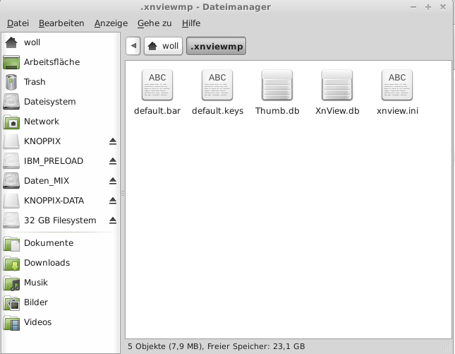

I klick "open the database Location" (Screenshoot ONE) and this folder will be open...... see Screenshoot TWO. Inside this folder there are objects:
- default.bar
-default.keys
-Thumb.db
-XnView.db
xnview.ini
Where i have to create a new txt-file? Should i open one of these 5 files? use gedit or Leafpad. My Database should be saved on my FAT32-Partition called "Daten_MIX"..... and my WindowsXP-Partition is called "IBM_Pre..." see the left side on picture TWO

I don't like at all the name of the folder: woll .xnviewmp For me, this is a hidden subfolder in your home folder. On Linux.
Theoretically you need to create the text file in the opened folder from screenshot TWO (there where xnview.db and thumbs.db are located). However, I think that it is quite clear that the folder isn't correct.

2. In the Screenshot ONE you have next to the button "Open the Database Location" a dropdown list labeled "Folder for Database (.db)" - change that from 'User (System)' to 'Custom'.
3. After this press the '...' button next to it to choose the (new) location of the database. A navigator window should appear with which go to your volume (Daten_MIX) and select there your desired folder. Save & close the navigator.
4. (optional) Press the 'Open the Database Location' again in order to see that the XnViewMP really points to your folder on Daten_MIX. Perhaps is better to restart the XnViewMP and check again.

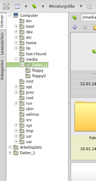

In Linux_Mint OS i have in my folder-tree my picture-folders two times. My Fat32Partition is mounted. Please look the attached screenshot.
So, on the tree in he middle there is the same folder, green line marked, and has the same objects inside (Pictures) inside, as the folder at the bottom on the tree.
The path for the middle-folder is: //media/Daten_1/....
The path for the folder at bottom is: /media/Daten_1/....
Only in the folder at the bottom, all changes from winXP-area will be showed, but not in the folder from the middle of my folder-tree, but the pictures in both folders are the same.

Why the folder appears two times? IMHO this is a Mint/FAT32 mounting daemon problem, unrelated to XnViewMP.In Linux_Mint OS i have in my folder-tree my picture-folders two times. My Fat32Partition is mounted. Please look the attached screenshot.
Perhaps you can try to make both installations to look at the folder at the bottom? (the one which let you see the changes from WinXP: /media/Daten_1/...)
