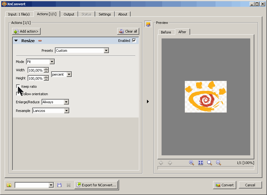

Re: [v1.60] “Keep ratio” broken
[ Animation ]xnview wrote:i can't reproduce, which values do you have?
Expected behavior: If Keep ratio is activated and the value for Width is increased or decreased, the value for Height should change accordingly in real-time and vice versa.

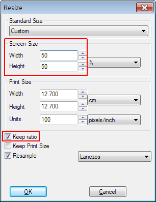

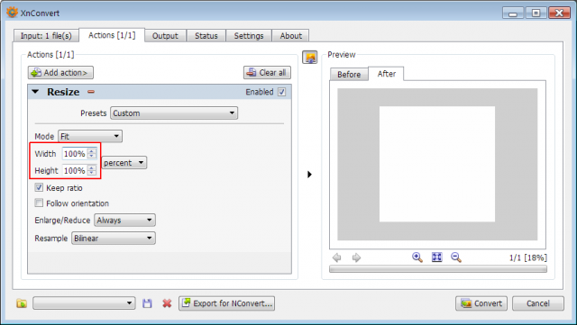

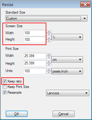

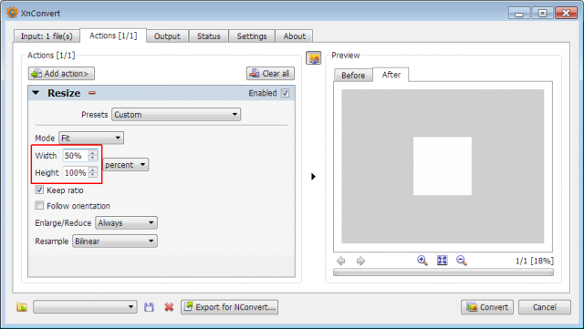

I think there is a problem but it's possibly slightly different from the issue described above...
Edit: I found the animation a little confusing but reading the text above I think we're saying about the same thing:
The XnConvert 'Resize' function with the 'Keep ratio' option selected should work the same as the 'Resize' function in Xnview 2.13 -- if 'Keep ratio' is checked, changing the Width should result in the Height changing to match:
Before: After: In XnConvert with 'Keep ratio' checked, changing the Width results in the image being resized correctly with the ratio maintained, but the Height value displayed is not changed to match the Width change as it is in XnView:
Before: After: The fact that the Height value displayed doesn't track the Width change displayed seems to be the only problem.
Images are for XnConvert 1.55 due to the Resize bug previously identified in 1.60.

The Enlarge/Reduce -- 'Always' / 'Reduce only' / 'Enlarge only' option determines how a particular image is processed, but when 'Keep ratio' is selected the displayed Width and Height values should always follow each other, as in Image > Resize... ?
The Preview displays changes as expected.

I agree that the values of Width & Height shouldn't be linked for pixels, but I was referring to resize by percent (see screenshot).xnview wrote:yes it's normal, 'keep ratio' is applied only when processing, depending on the image size...
