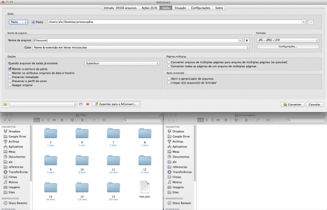

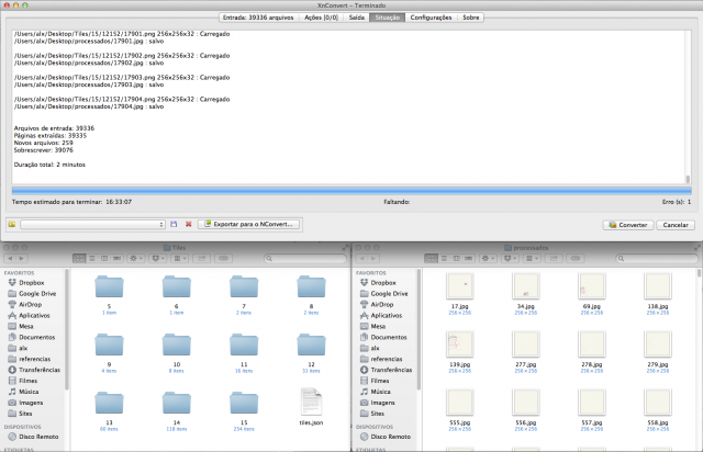

I found some posts about it, but no one solve the problem. The "Keep folder structure" does not work, like you can see on these images (before and after the proccess):
The folder "processados" does not have the same structure as "Tiles". What can I do?

yes it's bug, i'll fix it...
Bug confirmed and will be fixed. See issue Issue 234 for current status and details
