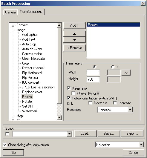

XnView Classic is capable of resizing images of mixed orientation to a common height.cday wrote:Can anyone else see a way of doing it?
Tools » Batch Processing... » Transformations » Image » Resize » Parameters
- Width: leave blank
Height: [ 750 ] (pixels)
[×] Keep ratio
[ ] Fit over (W or H)
[×] Follow orientation (switch W/H)
Only [ ] Decrease [ ] Increase
- Landscape (W×H in pixels): 2032×1524 » 1000×750
- Portrait (W×H in pixels): 1524×2032 » 562×750

Thanks for all your help chaps. I found XNConvert completed the automation simply by setting a value of '0' to the variable axis - in my case the Width. (I wasn't able to leave it blank as XnTriq suggested)
Happy days, all images now reduced in proportion to match the height of say a web slider or even a Slimbox gallery.
Note: This also worked in XNView.
