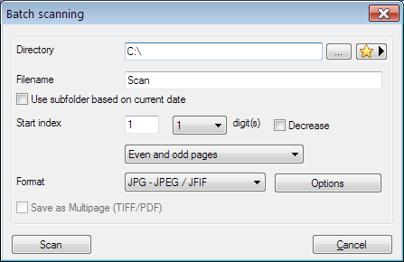

Have you tried scanning from within XnView using File > Acquire into... ?
You should then be able to enter your desired scan prefix and also be able to control how scans are numbered; if you are scanning a book you also have options to scan all the odd pages and then all the even pages and have the page numbers automatically interleaved.
If you have more than one scanner installed, you may need to use File > Select TWAIN source... to select the scanner to be used.

XnView settings are normally saved to the ini file but at a quick look I can't identify the setting you need, if it is there.
The ini file location is user selectable: see Tools > Options... System integration. Alternatively, if you uninstall XnView and then download the zip version you will find the ini file in the folder, named 'xnview' type 'Configuration settings'. If you open the ini file in a text editor you may possibly be able to recognise the setting you need to change.
However, if your scanner has a TWAIN interface, which it very likely does, I would again suggest trying scanning from within XnView, as I think you may find that it meets your needs with respect to setting a directory and file naming, and if you need to enhance the images in XnView after scanning it is easy to step through them if the file format is associated with XnView.
