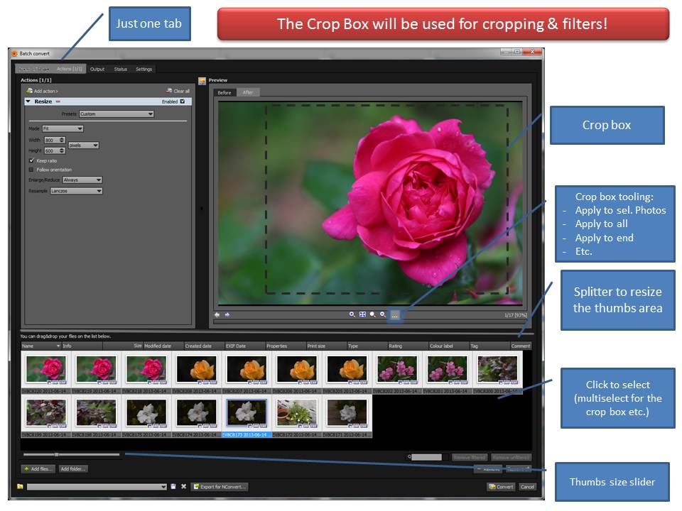

We had these days some requests about improving the navigation and cropping in our Batch Processing engine.
IMHO these request can be very elegantly handled together and more, enhancing a lot the batch cropping feature making the best in class solution for digitizing companies and for any other user who have a lot of images (usually from scanner) who need cropping. Yes, I know - we did a lot of these, both in cooperation with big companies and by ourselves.
The GUI should look something like this:
...With the appropriate tooling to batch apply the crop box to the selected photos, to all photos, "from Current Photo till Begin/End" etc.
As you see, is very easy to do it, in fact just a relocation of the existing screen widgets from separate tabs together and a link between them.
Internally the program will have in the list of files two fields: Filename (a string - field which already exists) and CropBox (a structure of 5 numbers: 4 integers describing the cropping rectangle and a float for the rotation angle). Of course, when CropBox is (0,0,0,0,0) means No Crop.
Also, the crop box should be used not only for cropping but also it will act like a mask for different filters.

Let's take it step by step.
What's happening when the user wants to do a Batch Convert?
1. Selects 123 photos.
2. Goes to Tools | Batch Convert...
And then the program does like this:
2.a. Builds a list of 123 TmyFileEntry objects containing the file names and thumbnails of the selection from the step 1.
2.b. Show the Batch Convert dialog with the 1st tab filled with thumbnails based on the list generated at step 2.a.
At this point I propose the following changes:
2.b.1 Move all the widgets from the Batch Convert's tab "Input:" on the bottom of the second tab ("Actions"). We'll have a layout quite similar with the Compare window. The main reason of this move is to enhance the navigation for the Before/After views in the "Actions" tab.. Of course, when the user clicks on a thumbnail, the corresponding image will be shown in the Before/After pane.
2.b.2 For each entry (object) in the list generated at the step 2.a. add a new property (struct) with 5 numbers (4 integers + one float) to hold the crop information. Initialize this to (0,0,0,0,0) - no cropping information
Till now we have a much better navigation in the Batch Convert window and a struct for each file object doing nothing.
Next step is to add the crop box support:
3. Allow the user to drag a box on the After view in exactly the same manner we can do it today in View mode.
4. Store this info in the struct defined at step 2.b.2
5. The critical part: In the Crop action, besides options "( ) from position" and "( ) from edge" add another one: "( ) use crop information (box)"
If the latter option is used then read the struct filled with data at step 4 and crop accordingly.
6. (optional, but highly recommended) Add at all filter actions from Actions menu a check-box saying "Use crop information". Then the crop box will act like a mask. Exactly like in View mode.
7. Add a tooling button (see the position of the button in the mockup in my original post). This is very important because in the case of scanned books / documents etc. the crop area is nearly the same on many documents and hence a way to "copy" the coordinates of the crop box on many photos is very necessary and gives us with this simple tool the state of the art in batch cropping.
