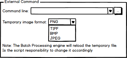

Add the ability to launch into "Batch Convert" custom script
Post by oops66 »
It would be very interesting into XnViewMP under Tools\ "Batch Convert"\"Action tab" to allow to the user to launch a custom script (by iteration for all input files) , ... for example here:
imagemagick and exiftool bash script: autotone4xnview.sh :
http://www.fmwconcepts.com/imagemagick/ ... /index.php
autotone filter = auto brightness/contrast + auto gray balance + auto white balance + auto gamma correction + auto noise removal + auto sharpening (all in one filter).
Image ... after ...> Image

So, as you say, perhaps the best solution would be (besides having certain code inside) a Batch Convert Action like this one:
Which will do the following:
1. Save the image from the memory in the state in which it reached in the Batch Convert pipeline to a temporary file with the format specified in the dialog above
2. Run the command with the full file name as argument (don't forget to quote it) and wait for the script/process to finish
- It is the script responsibility to handle any other parameters / processing etc. as well as saving back the changes to the temporary file
3. If the temporary file is changed (and still exists, of course), reload it in the image from memory.
m. Th.

So, as you say, perhaps the best solution would be (besides having certain code inside) a Batch Convert Action like this one:...
... Yes I prefer this approach ... (so the last "filter" in BatchConvert is the custom script in option) ;-)
Isn't needed to be the last "filter" :) ...of course if you're "good guy". :)
Because as you see at the step 3., the temporary file is reloaded. Or perhaps your script goes out from the processing pipeline like in the example of Multiple Crop which you posted above?
m. Th.

Something like this.

i don't understand you means external script file?

Yes.

...to complete: in the example described the custom script file would be just a copy in order to save the intermediated result in a separate file.
m. Th.
