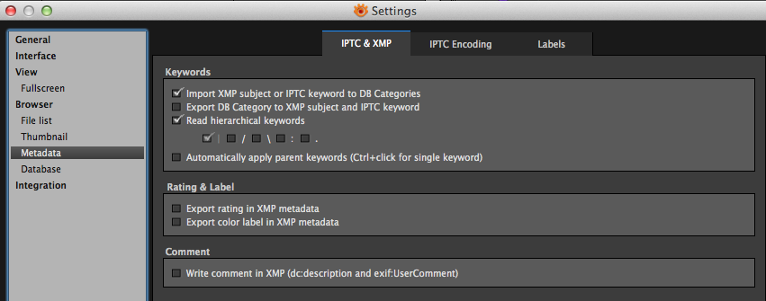

Many thanks both. If I just want to stop writing separate XMP files, what settings should I use? I have them set as follows at present. I don't suppose it is possible to force XMP sidecar info into the jpeg or dng?
1. PRAY A LOT for Pierre to implement the new Medadata storage engine described here: http://newsgroup.xnview.com/viewtopic.p ... 45#p118264
2. Let's clear the things a bit:
What you're looking after is Metadata. Metadata is "more data about your photo". In (y)our case I think that's RCK (Rating/Color/Keywords - or Categories in XnView).
XMP is just a standard to present this Metadata.
Sidecar is a file (dependent of the main file - the image) which holds the Metadata encoded in various formats. Of course the most common format is XMP. Hence usually we talk about "XMP Sidecars".
Till here is everything clear?
Now on:
Indeed, there are some formats which can embed the Metadata inside of them. JPG and DNG are two of these.
For JPG I know that XnView MP supports it. With DNG I don't have experience (I keep our Raw files as they are).
In your screenshot, in order to "force XMP sidecar info into the jpeg or dng" :) you must check all three 'Export' checkboxes. If you want, perhaps is better to check the last one also ('Write comment in XMP...")
