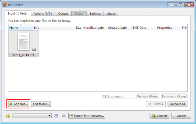

An example of converting a multi-page TIFF file containing four 1-bit black and white images to a multi-page TIFF file with CCITT G4 compression, using XnConvert 1.63:
The input multi-page TIFF file was created from four single page 1-bit images with LZW compression so that the file was small enough to upload; the file size is 597 KB compared with the total file size for the four uncompressed single files of 3.10 MB.
First load the file to be converted...

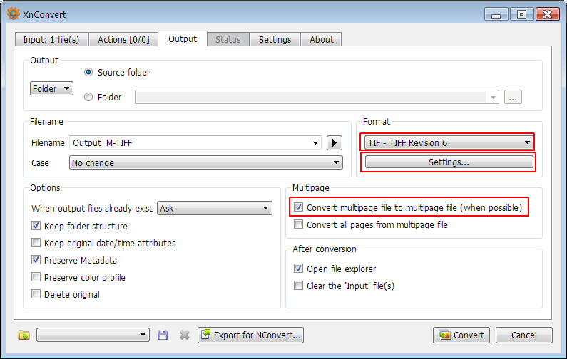

There is nothing to set in the Actions tab, but note that when a multi-page file has been loaded the Preview function on the tab only shows the first page image, it isn't possible to step through the images as for single-page files.

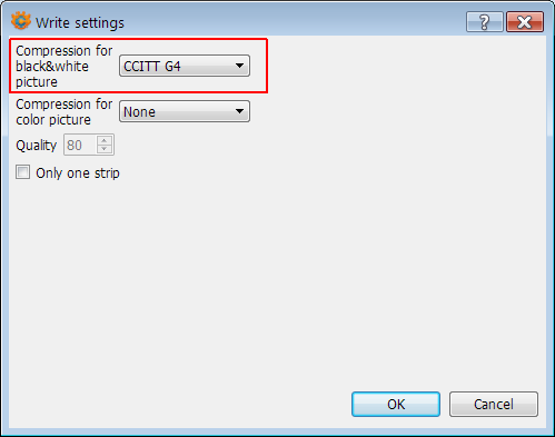

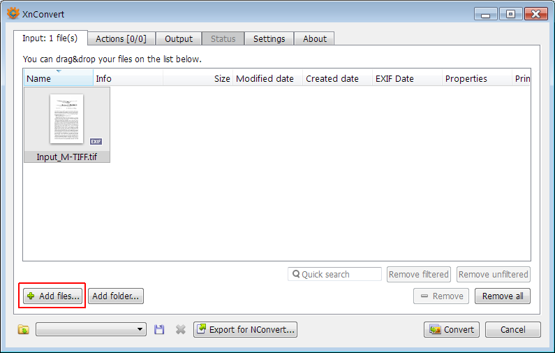

Set the Format to TIFF and then click on Settings...
Select CCITT G4 compression.
The input multi-page file and the output multi-page file with CCITT G4 compression created are attached -- note the reasonbly small file size for the output file; a file using JBIG2 lossless compression if it could be created might be around 20% smaller.
