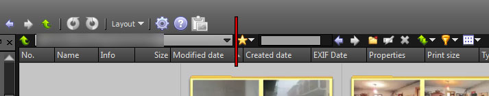

2. (Much better): Pray and ask Pierre to add a "Show all files (recursive)" button on the file toolbar - at the red line indicated bellow:
It is very easy to do it - the code already exists, Pierre needs only to surface it properly in GUI.
